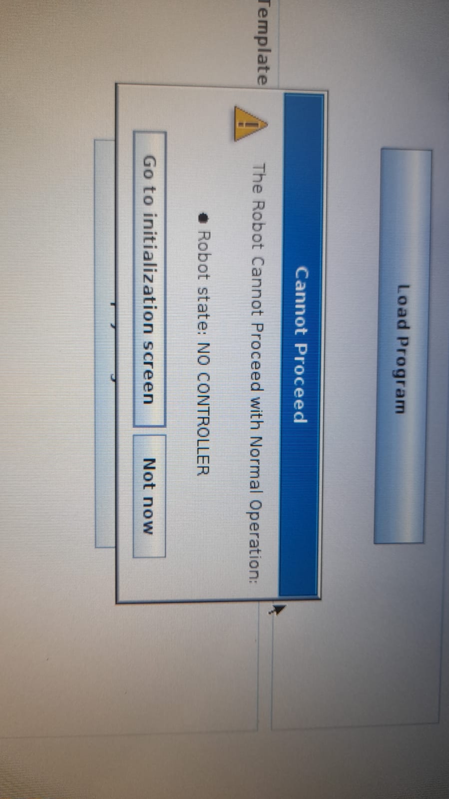

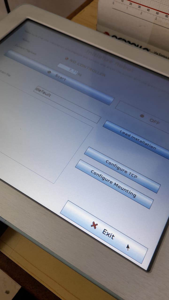

I have problems with a UR5. the error that comes out is NO CONTROLLER. and I can’t start the robot.

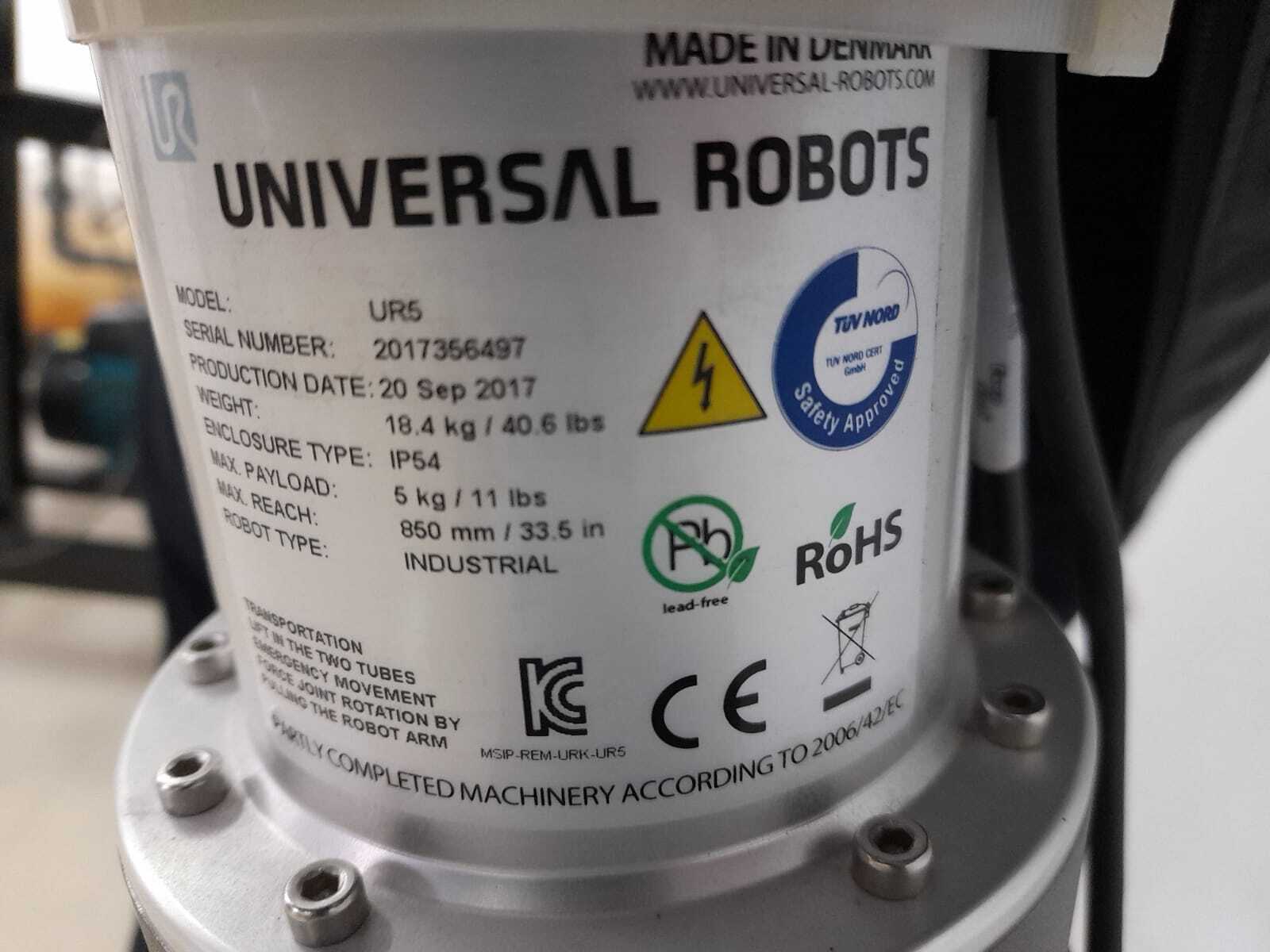

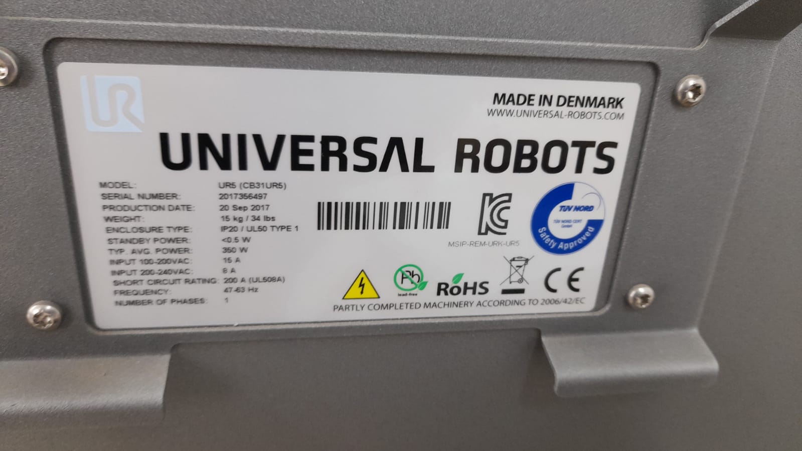

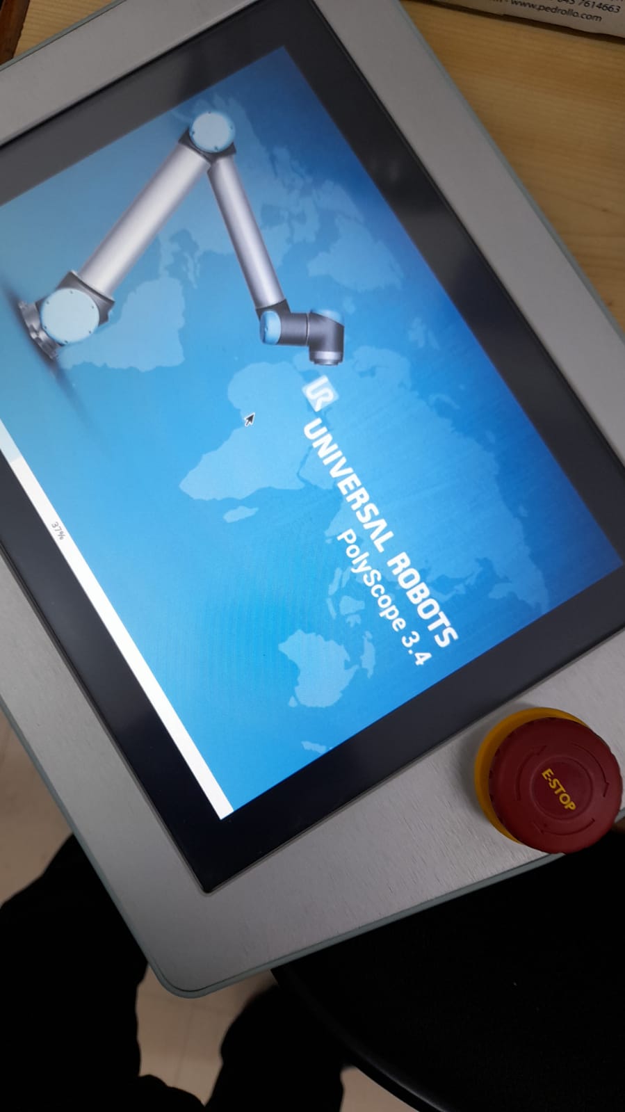

Attached photos of the error, also of the version of plolyscope, version of the cabinet.

This is just generic message that lower level controller is either stopping, or can’t start for some reason.
Normally local tech support should be able to help you.
Software 3.4 is also quite old. Upgrade to at least 3.10 where improvement to diagnostic files were introduced, or preferably to 3.13 where feature was added to export diagnostics files to USB drive.
Worst case it’s also possible to refurbish robot with completely new operating system. Just remember to backup copy all programs to usb drive.

Hello. Thank you very much for your prompt response. I’m from Lima, Peru. And technical support is very limited. That’s why I turned to the universal robots forum. The new software to reinstall it where I find it. On what page. Another query. In the software update it would not affect the hardware since the equipment is from 2017 I guess the hardware changed. Greetings. I await your prompt reply

You’ll need to go through one major version at a time (3.5, 3.6, …), so there is some art involved in update. OS reflashing is quite advanced operation, so you may need some IT help anyway.
Software is backwards compatible, so it will work fine with robot from 2017.

I removed all the cables and put them back. and then I measured the output voltages of the source which is -257.0 mV. apparently the source is failing.

I’ve had this happen because I didn’t update the firmware to the joints (in the low level control).
This can also be as simple as a loose USB/ SD card
Last, I’d recommend updating the polyscope to the latest version.
