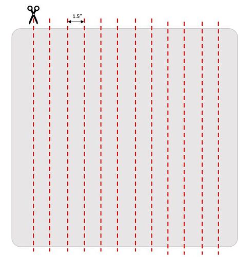

My facility uses our cobot to cut material into a strips of the same thickness. Previously, we have used the pallet function to repeat this motion, but I was wondering if there are any other functions that may work better. Possibly the “At Each Item” function?

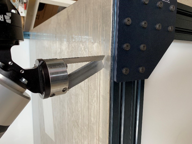

See the attached pictures for the cutting tool we have attached to our cobot arm and the pattern we are hoping to cut.

Yes, the Force command is pressing down on the table top, although it does not always cut through the material (It will use the force command directly on the tabletop and then Move to cut a straight line. Once the tool makes contact with the material, sometimes it will push the blade up, thus preventing a full cut through the slab)

Problem #1:" Once the tool makes contact with the material, sometimes it will push the blade up, thus preventing a full cut through the slab". I think cause by uneven material or friction when knife is in the middle of plate or material is cornered due to blade not sharp enough.

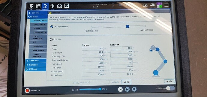

In the ’ Safety setting’, Have you set the maximum power and torque?
If everything is set to maximum then the robot probably doesn’t match the required capacity.

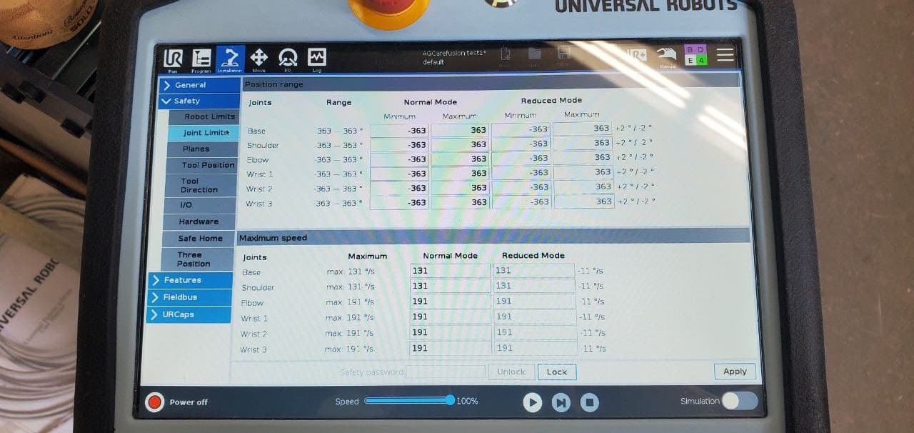

pls check it in the:
  • Installation
  • Safety
  • Robot limits
  • parameters: Power, momentum, force. change maximum.
See attached pictures
I will look into power, momentum, etc parameters shortly
yes. Currently, The robot operates at average level.
Let change it to maximum and try again.
I am unclear. How do I change it to maximum? Do you mean set it to “least restricted”
