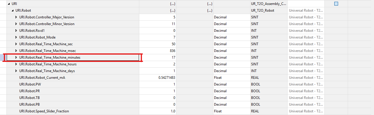

Ok then what about about the URI.Robot.Real_Time_Machine what is that tag and what does the value represent ?
That’s how long the robot has been powered on. Just the number that is displayed on the run screen
