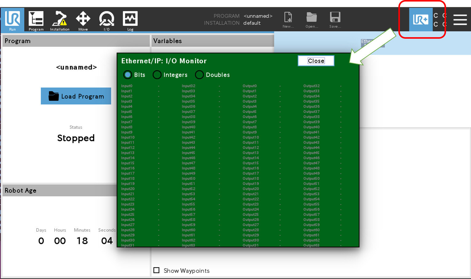

Hi.
I recently updated the urcap sample for Ethernet/IP monitor.
It can be launched from the toolbar on e-Series.
I hope strongly that this is implemented as default feature of Polyscope!!

Thanks for your work,i have been using your urcap to debugg with plc it helped me a lot. I’ve tested wiith a UR10e V5.11.0 and it works.
There is an old issue in v1.0 and v1.1
When it is configured a signal in the I/O setup in the upper range (bit [64-127], integer[24-47], double[24-47]) it gives and exception

Hi, I wanted to know if this example also works for input tracking or does it only work with outputs? Because I wanted to connect it to a robot and I wanted to know if it reads inputs.
This sample can track both input and output data.
