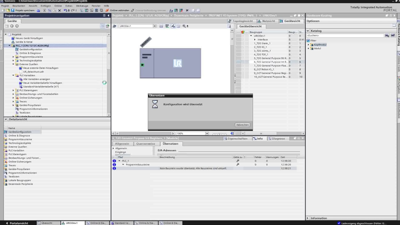

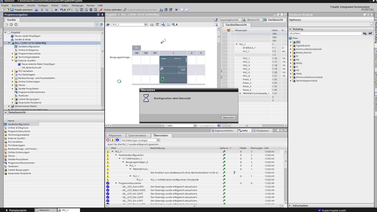

UR5e not reachable with profinet
Hello!
We have a problem with our URIOdev and modules that are not reachable. We have followed universal robots profinet guide and also some tutorials from this forum.
https://www.universal-robots.com/articles/ur/interface-communication/profinet-guide/
We are using siemens S7-1200 1211c firmware v4.4
TIA portal v16
The error messages that pops up is module not reachable.
have you added a connection on the topology view, also? I had the same problem and then I added the connection in topologi view and the problem is solved.
I have this problem as well
Can you ping your robot from your computer? :slight_smile:
You shouldn’t connect the UR to the PLC in the Topology view. You will probably get a warning/error when compiling.
The first video tutorial does not mention assignment of device name in TIA. It’s a very important step.
Have you assigned device name to the URIODev1?
Try rebooting the robot after changing its IP address , the topologic view of tia portal´isn´t neeeded.
I had this problem and i went mad until i thought of just rebooting the robot ,as soon as it powered on , PLC turned green , i am not sure if it wa sluck or maybe that UR doesn´t relaly change the address until it reboots .
Hope it helps!
I have completed this step yet I am stuff unsucccesfull
rebooting did not fix the problem
If you send your robot program (urp and installation) and TIA project, I will take a look at it. :slight_smile:
ur_2017306928_2022-11-04_09-15-44.zip (5.5 MB)
Universal robots project.zip (1.2 MB)
I think that you mean these files correct?
You do not have a router between the PLC and UR, right? :slight_smile: If you do, try without it.
Also I recall having trouble before using a custom PROFINET Device Name. Give it a try with automatically generating a device name. :slight_smile:
After changing it to automatic, you will of course have to reassign the device name for the UR.
The 1215 PLC has 2 profinet input so there wasn’t a need to use a router.
I have no idea how but after leaving the robot alone over night and starting it up now it suddenly seems to work.
Thanks for the advice even if it seemingly wasn’t nececary
