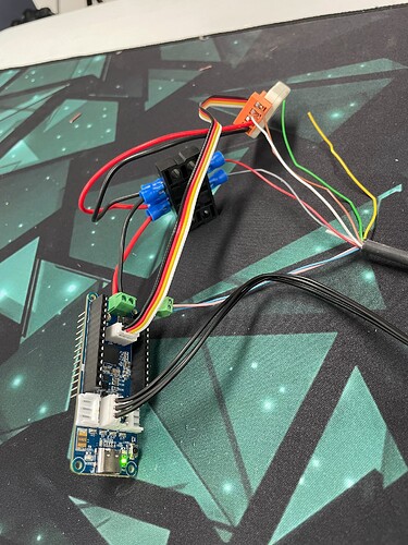

My setting consists of PC, UR3 and dynamixel.
PC and UR3 are connected with ethernet (Master: PC , Slave: UR3)
UR3 and dynamixel are connected as
DXL –– OpenRB-150 ––<M8 8pin cable>-- UR3
I attached the image of setting below.

First, set wiring of UR3 and openRB-150 correctly.
Second, write a .ino code for openRB-150 and upload it via arduino-ide.
Third, write a python code to control the end effector via RTDE.
  1. Wiring
UR cable is a M8 8pin cable which has 8 color cables in it.
Each cable has its own signal domain.
We only consider ground, input voltage, tool output.
RED : ground
GRAY: 12/24V
BLUE: tool output 0
PINK: tool output 1
I connected each cable with openRB-150 as
RED : ground — Terminal VIN ground
GRAY: 12/24V — Terminal VIN +
BLUE: tool output 0 — PB10 (D4)
PINK: tool output 1 — PB11 (D5)
You can check the details of openRB-150 in here
Also, you should set UR3 output voltage to 12V in teach pendent.
