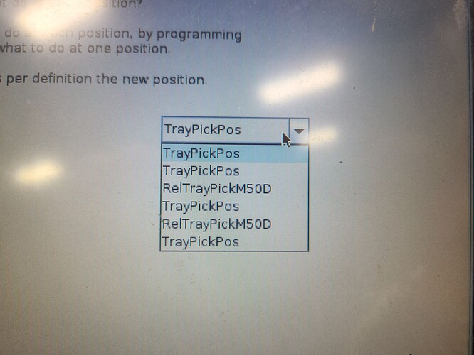

UR5/CB3 - Cannot assign a WayPoint to an existing Point, only create new ones
I had a working program at one point, but periodically I lost the ability to Rename Waypoints and at the same time or related to the same time, the ability to use a Defined Waypoint more than once without using a copy / paste. I had added a lot of reused moves using copy / paste at the pendant. This was in version 3.11… We also had very odd things happening with a palletization routine, and could only recover proper movement by creating a new one (same corner geographically and approach position). At one point, I found the dropdown list of waypoints to include the same point multiple times (see attached image). I also had instances where waypoints referenced in the program randomly renamed themselves to other waypoints, and upon moving to that position, it would be a completely different position. I had two instances of a waypoint that each went to different locations.
I incrementally upgraded from:
update-3.11.0.82155.urup
To
update-3.12.1.90940.urup
update-3.13.1.10297.urup
update-3.14.3.1031232.urup, and
update-3.15.8-build10.6.339.urup
Each time I fully rebooted and restarted per the guide and tested to make sure the basic features of my program worked, and didn’t notice a structural change in any code. Each time, I could not use a waypoint more than once, without cut and pasting the waypoint. When I got to update-3.15.8, A whole ton of Indexed (-1,-2,-3…) waypoints appeared, see attached picture. I have included a video here also.
I think some how cut and pasting waypoints cause a whole ton of reference errors in the compiled version of the program. I downloaded the simulator, and copied my program into the simulator, and the same thing happens in there.
I got frustrated, and deleted all my waypoints, suppressed all but the minimum code (to mask the missing waypoints in the Move Statements) and still have the same issue with inability to use a waypoint more than once (NOTE, these are FIXED waypoints, not sure about relative ones).
This sure seems to be a bug within the Pendant… Did my cut and pasting waypoints screw up some sort of tag tracking??
