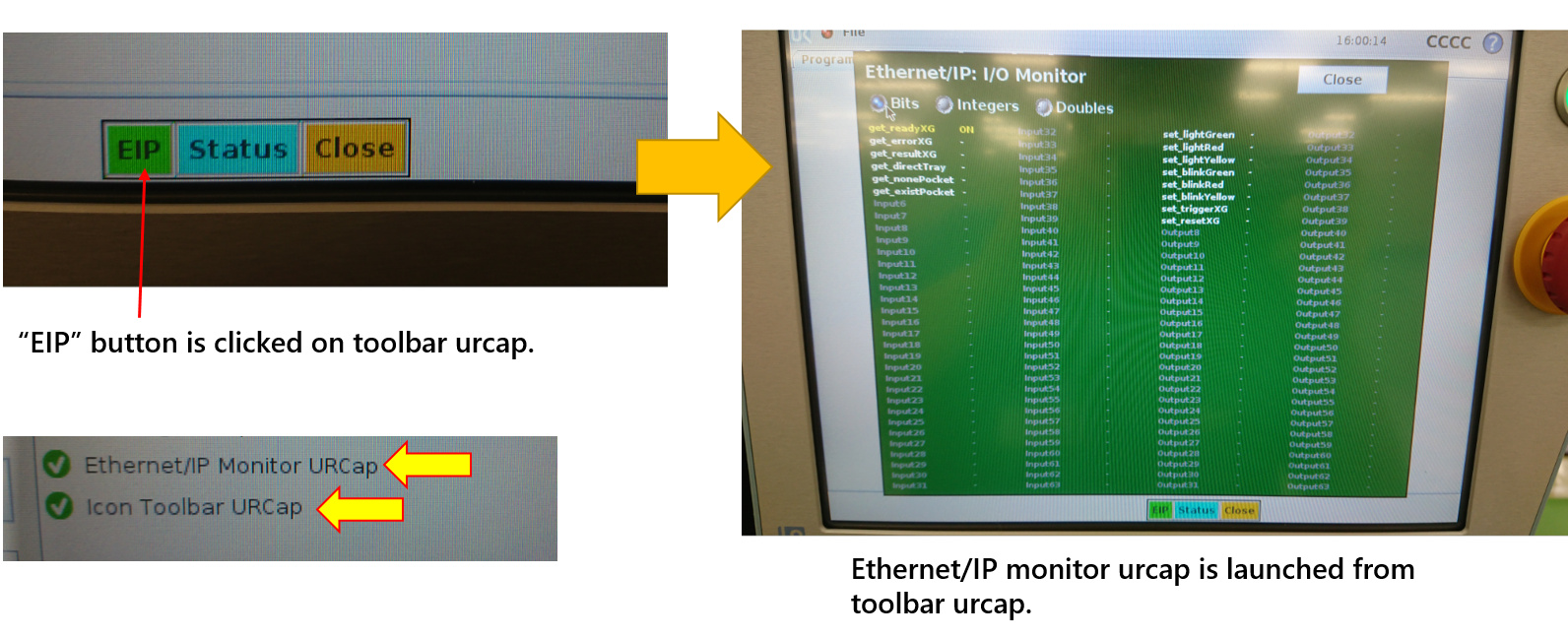

Technical trial - Communication between two URCaps (URCap launches the feature of another URCap)
I have tried that one urcap launches the feature of another URCap.
My trial is the below.
  1. Toolbar urcap is launched from installation node.
  2. Ethernet/IP monitor urcap is launched when “EIP” button is clicked.
I will upload the sample code into github if some developers think that they need this feature of urcap communication.
