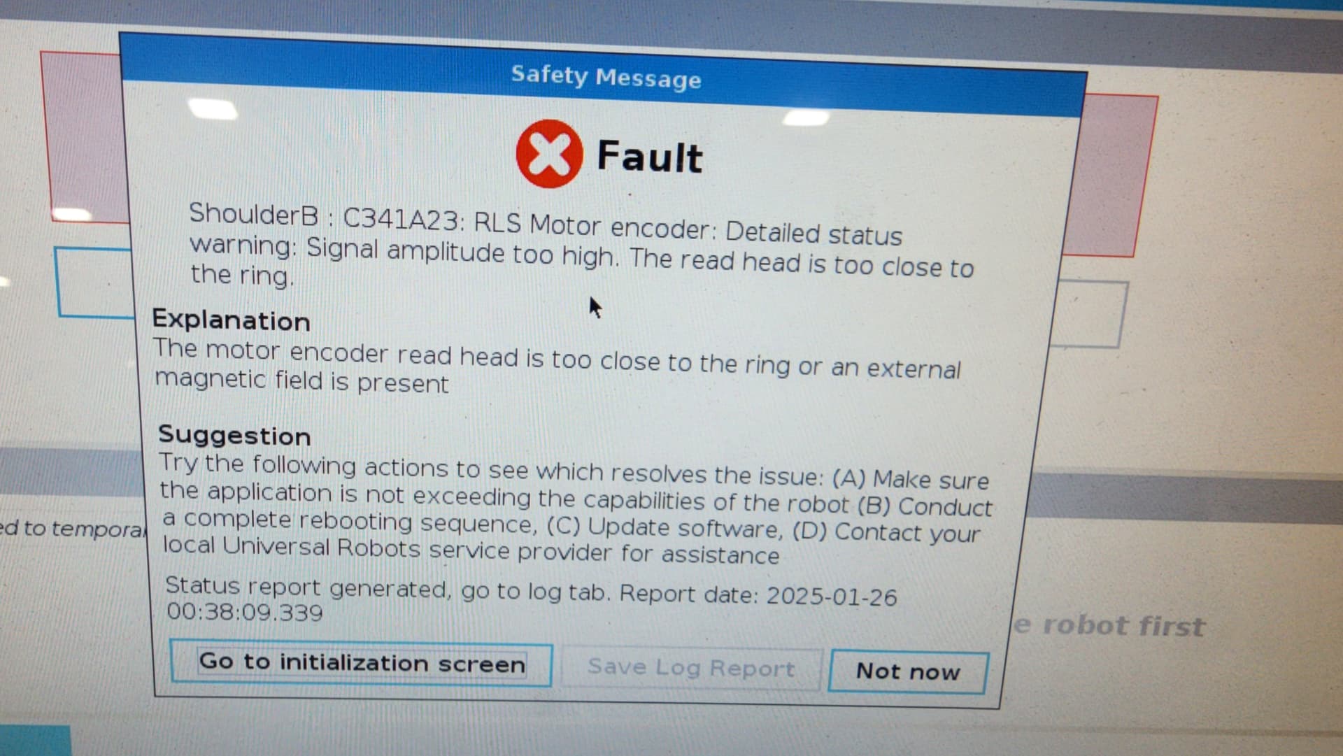

ShoulderB : C341A23 : RLS Motor Encoder Fault
Im getting a ShoulderB : C341A23 : RLS Motor Encoder fault. Its a new robot with less that 60 hours on it. Any idea?
Well. It’s quite clear from the message, that there’s something wrong internally in the shoulder joint. :slight_smile:
You should contact your distributor and have it fixed under warranty (if it’s also new with regard to production date).
Yes, UR determined it was a bad encoder and a replacement is on the way. I was kind of hoping it was something in the programming or something I could fix quickly. Especially since its a brand new robot.
If I remember correctly, we had a bad joint right out of the box on a unit last year. It happens.
