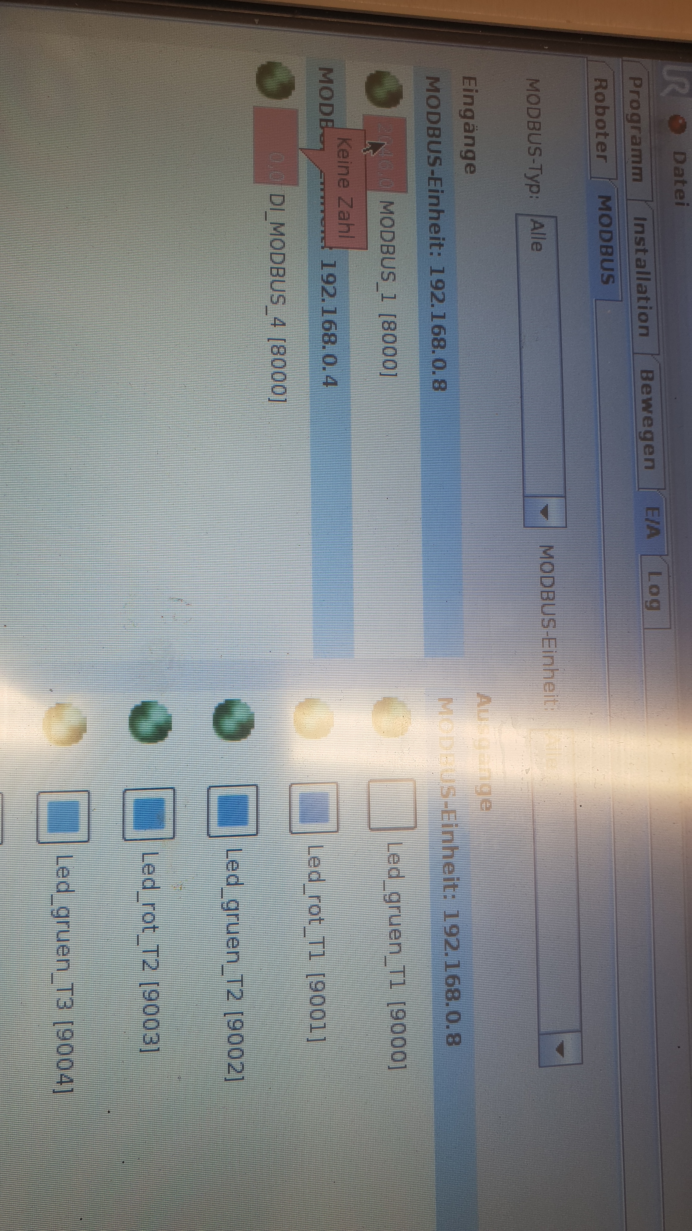

I/O Screen (PolyScope)
MODBUS-Einheit: 192.168.0.8
“Keine Zahl”! <- MODBUS_1 [8000]
After the update (UR5) to 3.11.0, there were problems with “old” programs using Modbus I / O. After the start of these programs there are several error messages “Software error!” with NullPointerExceptions. After closing the messages, the program and the Modbus communication are running smoothly.
in the logfile an error message with the code C0A0 is generated.
If we update the Modbus on the Installation tab before starting the program, these error messages will not be displayed.
(Or less of them)
The I / O tab displays an error message on the Modbus screen. “Not a Number” appears on the Modbus units instead of an integer value (word).

We have found this bug internally as well.
It will be fixed in 3.12.0.
