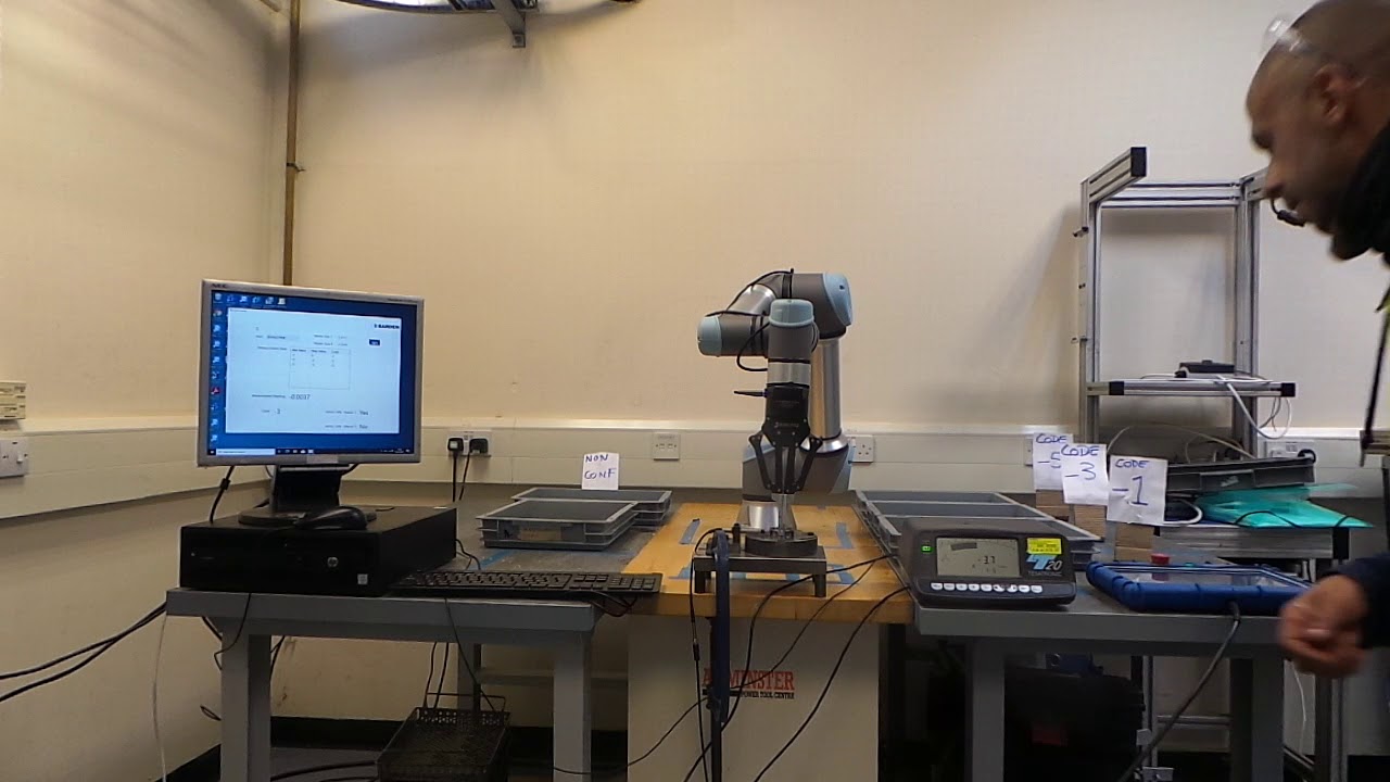

We currently ready to put our cobot onto the shop floor, the problem we are facing is that the operation will be measuring outer diameters of our bearings, we work with batches at the moment our setup is for a 42mm od and with a 12mm width
as seen in video
coding
it measures a part on a gauge and codes it then puts its it in the corresponding code tray.
What we trying to do is make it quicker to setup for different size parts when they get put on production.
because we have parts that may have 2 codes needing 2 trays or parts that have 8 codes that need 8 trays.
plus the output trays pallet pattern will be different depending on size of the parts.
Don’t have enough info regarding the variables you will encounter with the different bearings so i’m just kind of guessing… Is it possible to set up the program with the max number of codes you will need (including pick and place pallets)?
That way, if a batch of parts only has 2 codes it can just ignore the unused codes/pallets. If it has 8 codes the pallets are already defined.

ok ive set a 1 pallet(tray) to a feature plane 1, is there a way then I can offset the feature plane for the 7 other trays
video here of our trial but the parts only have 3 codes so only 3 output trays required.
The program running in the video is coding 171 parts parts dimensions are 42mm o/d 37mm i/d and 12 mm width,
but like i’ve said this will be coding various size parts depending on what get pushed to the coding area within our firm, so we will need to be able to set up the output trays according to the size and codes. And when i mean by codes some jobs will have 2 codes so two trays be needed, some jobs have 3 or 4 codes so need equivalent amount of trays and one job has 8 codes
Sorted, what I have done is define all the trays as planes, and all I do know is set one tray with the the palletising template and set the pallet properties feature to the plane of tray 1 then i copy and paste the the palletising template and just change the plane relevance to the corresponding tray.
The example in the picture was a direct copy from tray 1 palletising template where I just changed pallet properties feature to point it at the scrap tray
