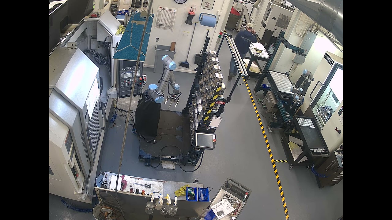

Maybe this is a simple thing and I’m just a dub who doesn’t know or remember. I couldn’t find an answer thru searching online.
So…I have a UR10e. It likes to take off if I accidently double tap the jog key just right. It will drive off in whatever direction I tapped for about 3-4 inches. Unless it crashes into something, which in most cases it does. Anyone know how to turn that wonderful little feature OFF?
Haven’t seen this in jog mode yet, but it has started happening in the program tab to the vertical scroll bar:
Tap the up or down arrow just right and it will scroll 'til it hits the end or you stop it.
It’s not a software feature :confused: Possibly there is a hardware issue with touchscreen.
My touchscreen is less than 3 months old and this behavior JUST started. Is there a warranty that, if this is the issue, will cover this?
I think it’s more software than hardware. Or rather, the hardware isn’t faulty, it’s just weak. If you hold to jog, then flood the robot with socket requests, for example, it can’t spare any time to register that you took your finger off. So it just keeps jogging until the other robot comms have cleared. So what’s probably happening with “double tapping” is similar in that it gets stuck trying to process “move forward - stop - move forward - stop” rapidly, in addition to other various things running on the controller. That’s just my guess though.
It did it again to me the other day. I watched the screen. It showed the arrow grayed out as if I was holding it down. I got it to do it 2 or 3 times. On the third time I touched another part of the screen when it locked up and it seemed to snap out of it.
Someone mentioned maybe it was moisture from my fingers? Either way I’m not liking the responses. It’s a real let down when you watch one of your nice finished parts get dragged accross a table or your vacuum gripper get mangled.
Here is a video of the robot taking off on me. Luckily this time it wasn’t colliding with anything. You can see I’m walking away from the controller but it continues to move up in the Z. I’m so used to it doing this now that I didn’t really react to it.
