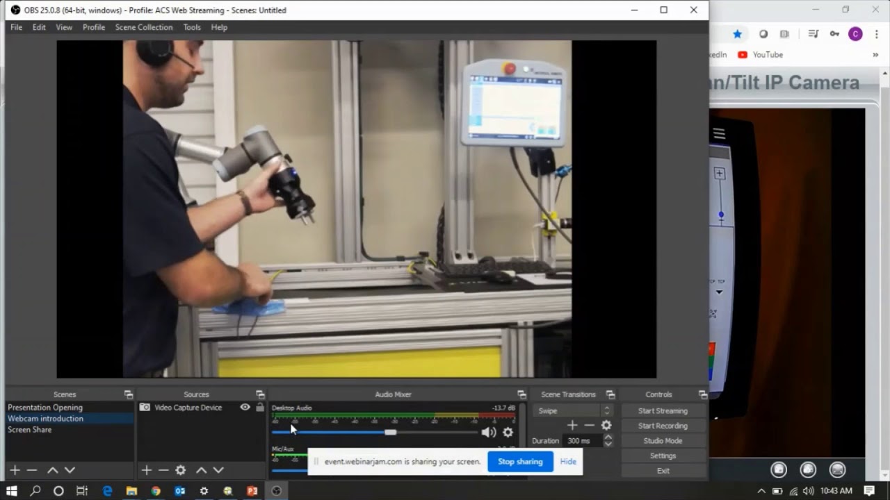

I’m trying to position my robot using a Cognex 7600 camera.
I followed the instructions as shown in the examples below.
At first, it worked well.
My problem is that my feature plane isn’t the same as the robot’s base feature. I had to create a new work plane.
I calibrate using the created plane without any problems, but the MOVE L command after the job pass, using the created plane, doesn’t work, only with the base plane.
It only works if I use the base feature.
Does anyone have any tips?
