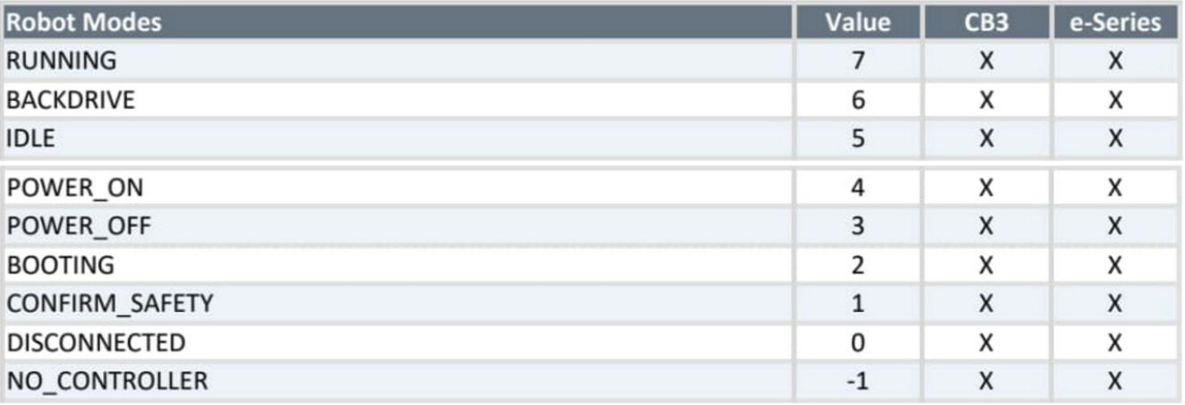

I mean you could observe the Input of ur safety guards and if the signal is not like u expect (E-Stop presed/ door open eg.) u can set a DQ and connect ur lamp/ horn at that DQ?
Or is ur robot connected to a PLC/ PC?
Cause then you could check for the Value of the Safety Mode of ur Robot:
Greetings from Luxembourg!
Hi @kadams
Can you share where you’ve found this table and what are these variables/states (ex. SAFETY_MODE_SAFEGUARD_STOP)? From what I can see e-Series is crossed out and not supported and I’d like to check to make sure.

It´s from the Dashboard-Server Manual.
My Robot is connected to a PLC (via Profinet).
Cause there i can read those Tags “Safety Modes” and “Robot Modes”.
I need those informations to reset my safety from my PLC (with an “automatic” routine).
