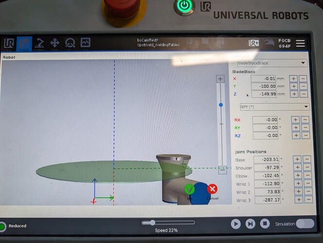

I will teach the waypoints with these coordinates;
BladeBlockStack: X=0, Y=-100, Z=-150, RX=0 RY=0 RZ=0
which translates in BASE Feature to: X=-491, Y=367, Z=160, RX=180, RY=0, RZ=90
I can save and run the program and it will work correctly.
Then I shutdown the robot and start it again. Don’t run anything or move the robot just go and edit that position and it will not be in the same position.

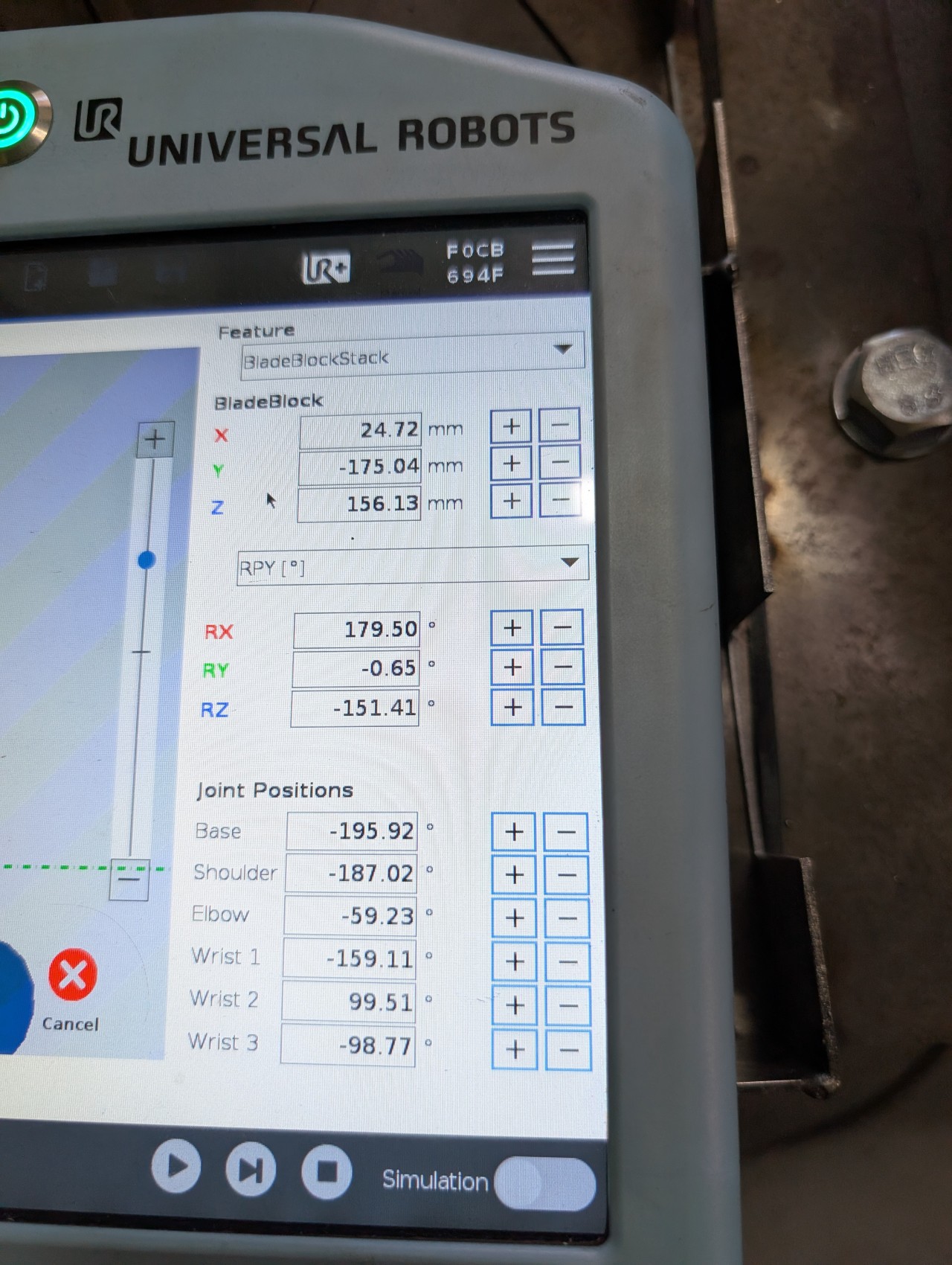

New Position BladeBlockStack: X= 25, Y=-175, Z=156 RX=180, RY=-0.65, RZ=-151
which translates in BASE Feature to: X=-566, Y=392, Z=-146, RX=-0.5, Ry=0.65, Rz = -118.6

After I Restart
Coordinates Before I restart
