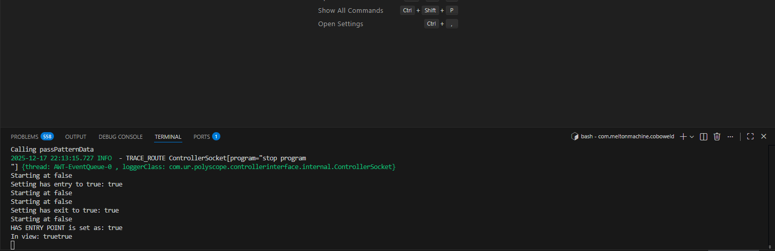

Where do the println calls get printed? I’m running the cap through URSim and can’t see any of my lines.
Not sure what your simulator environment is. But it should be showing up in whatever terminal you’re launching it from. For example, I use Docker and VSCode and the print statements are just in the Bash terminal:
So you’re running your sim by connecting to a localhost?
Yes and forwarding port 6080. So i login via web browser. To be honest I don’t even know how this thing is configured, I just followed the steps from a UR software dev. She gave me settings here: GitHub - pheobeyeung/universal_robots_sdk: Implementation of Universal Robots's SDK with VSCode Dev Container and Docker
Aha, I’m on port 5900 and using an app. I can’t see any output in my terminal.
This Docker thing will sometimes open 2 instances on top of itself, and I actually have to “power off” the robot (like via the hamburger menu on the teach pendent) and then a second simulator is already there. And for whatever reason my print statements were going through THAT instance
