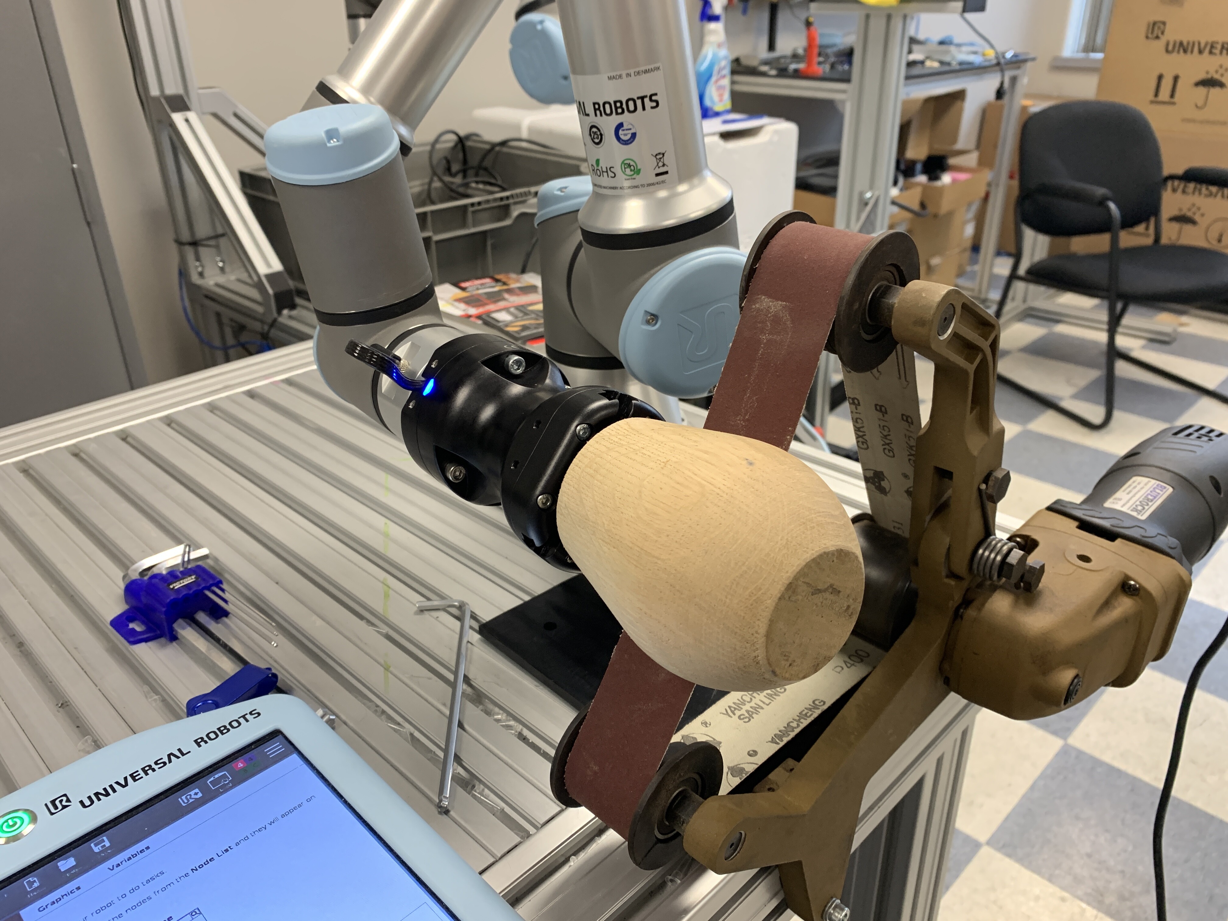

Using infinite rotation on UR3 to sand a wooden cup on belt sander
I am looking to program a UR3e to grab the inside of a wooden cup and sand the outside of the cup on a belt sander using a force move. In theory this seems easy but because my movement isn’t linear, I am having some issues. How would I program the movement to match the contour of the cup and simultaneously be rotating the tool? Any tips would be great as every solution I think of does not work how I imagined it to. The rotation of the tool is necessary to avoid possible flat spots from the sander.

I have tried the second option but I can only get it to work while doing a straight line. I can’t get it to react How I want while following the contour of the cup. This is just for a Proof of Concept right now so I probably won’t get into the tcp toolpath option but I might have to as nothing else I have tried has performed a fluent rotation. Using the force in Rz gives me the fluent rotation but I programmed a series of linear moves to follow the contour but while it is in the force move, it seems to just ignore all the waypoints and tries to just maintain its Rz rotation. Is there a way to combine force nodes? for example, can I keep a force on the Z base but also the Rz of the tool? I assume not.

[edit] Looking at the picture I’m not sure why can’t you teach a feature plane parallel with sanding belt, and ask robot to apply force only in Z axis of that feature.
MoveJ should still be able to maintain position control along tool Z axis moving cup back and forth, applying pressure against sanding belt at the same time.
I have tried that also. The problem is that it’s not a simple enough motion that I can just use 2 waypoints. I need to program a handful of them and when I do, there is a slight pause where the acceleration is ramping down and up to the next waypoint as the blends are really small. I end up with a pause in rotation for a fraction of a second which would mean a potential flat spot on the cup. This would all be very easy to do without spinning the cup at the same time but unfortunately that was something they specifically requested.

It’s quite a difficult task to do with normal programming. MoveP will respect rotations, but it has to be done in small increments - like 90deg at a time. Robot will try to maintain constant TCP linear speed, so TCP has to be offset from center of the rotation - maybe on the surface of the cup.
Suggesting a major change at this point of the project is likely unacceptable, but remote TCP was designed with these kind of applications in mind. Downside is that path needs to be created in CAM software, and then imported. I’m also not fully aware if remote TCP is fully compatible with force mode.
Yes, I tried that also. It does work but the max rotation speed is pretty slow. it would probably take like 8-10s to do 1 full rotation.
