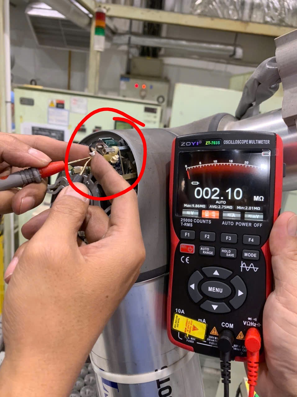

The brake solenoid coil is broken
I am using a UR10 robot. The brake solenoid coil is broken. Is it possible to replace this part individually?
Thank you for your support.
No, you should contact your local distributor to get the entire joint replaced.
