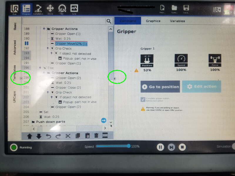

Is it possible to export the Robot Program as a PDF or JPG/PNG file?
Like in this example from the manual, you can’t read the programm properly:
In long lines from comments or script lines you can’t read the whole line even if you expand the programm window.
I want to document a long programm, but couldn’t find a way to show the whole programm itself.
There are two ways to see the program tree that I know of…

The second way, on the teach pendant, is to click the little “hide” buttons on the side of the node list. That will close or open the other two side panels and show the entire program node list on the teach pendant.
With the CB3 series it isn’t possible to expand the programm window to fullscreen. But with the e-series it is exactly how i needed.
Thank you very much.
