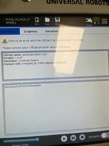

Hello, I have recently run into an issue using the palletizing wizard on the UR10e robot running Polyscope 5.13.1. I am running a program that calls multiple subprograms, each of which contains two palletizing wizards.
Yesterday, after I opened another program and then returned to the original program, the palletizing wizard, which had been working fine, suddenly crashed, giving me an error message and preventing me from making any changes to the corner points and the approach, tool action, and exit points. An image of the error message is provided below.
I’ve seen this a few other times by people reporting this, and it seems they are always using subprograms as well. It’s a bug on UR’s end, unfortunately, and there won’t be anything you can do to fix it beyond what you’ve done by reporting it. You could try workarounds like rebooting the robot or something.

Yeah so the error is actually happening either pre-script generation, or during. The null pointer is being thrown by the Java environment. So one of their methods is trying to operate on a piece of data that no longer exists. This may be stemming from a failure to correctly name the variables, as you’re describing, but you can’t really DO a whole lot with variables on the Java side, so I’m not sure. Just seems like every time I’ve seen someone post about the null pointer here, they are also always using subprograms, so I’m assuming that’s the underlying cause. Unfortunately, this issue still hasn’t been fixed, as you can see from this post (Java Null Pointer Error on Palletizing Node After Restart) it was reported as far back as 2021. (also here Palletizing subprogram gives error when clicked on 'Keep subprogram updated')
