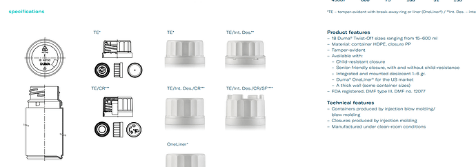

I would like to implement a child safety cap opening with a UR3. To open these cap, you should press the cap down, then twist it until the tamper-evident rim breaks ( I attached a picture of the caps). I want to implement the decapping procedure using the force sensor. So, basically, when the cap is still closed, the robot should sense a higher counter-torque given by the safety system. When the torque drops it should mean that the tamper evident rim is broken and the robot should stop applying a downward force.
How can I implement it?

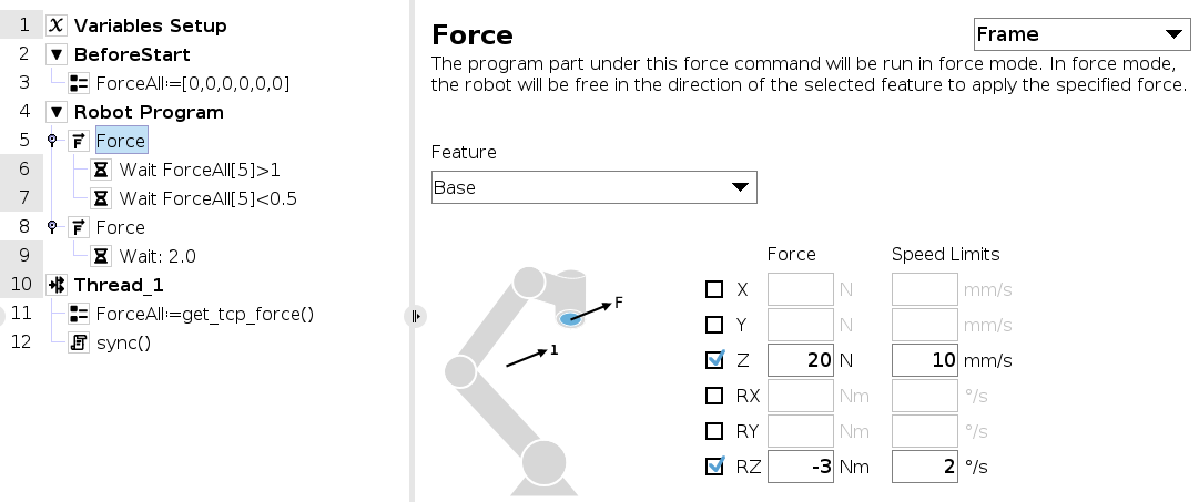

I would try to make it up of two Force nodes.
Start by making a thread that monitors the force in all axis’. Variable := get_tcp_force()
Then use a sync() to delay the thread as little as possible.
Then make the first Force node in Frame setting (upper right corner) with a downward force and rotational torque. Make the rotational force in Rz rotate slowly.
Then create a Wait that looks at your force reading in Rz (Variable[5]) and first make it wait for a high value then make it wait for a low value afterwards.
Give that a try.

So something like this? Do I need to add a move function?
thread GetForce():
 force = get_tcp_force()
 return False
end
thrd = run GetForce()
join thrd
force_mode(get_actual_tcp_pose(), [0,0,1,0,0,1], [0,0,-60,0,0,10], 2, [.1,.1,.01, 0.785,0.785,1.57])
# Then the two waits

Here you go:
Second Force doesn’t have the Z compliance.
