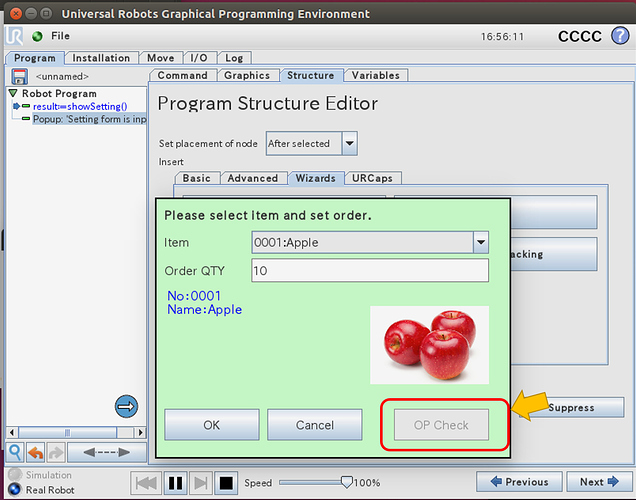

Is it possible to use a script to integrate a drop-down menu in a pop-up window to select different variables?
mbush in your picture it looks like this?
That’s just a static image that is being displayed on the web somewhere, we are just calling it back for display. You can popup a variable for the operator to fill in but I do not know of a way to display a combo box of variables like is shown in that example.
Ok, thank you very much for the answer. It’s a shame that this isn’t possible.
