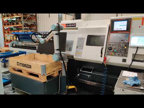

To recap the problem and desired solution, I do setups on two UR10e’s to tend CNC machining centers. Usually a few hundred parts to a couple thousand at a time, so a lot of turnovers.
I have a 3 x 4 foot table with plastic templates with grid patterns water jetted to hold as many parts as possible. The size and quantity is highly variable. Pict below has 2 different sets of templates.
I change setups at least once a week sometimes 3 or 5 times a week so I’m constantly setting waypoints against the walls of these templates and inside the machine in vises and/or fixtures.
Using Freedrive is not an option. Too much resistance in the arm to feel the walls unless you slam into them, then it bounces and you don’t get a good setting anyway.
Yesterday I made a short program that would simulate my requirements but it’s really cumbersome and the TP gets really hot after about 15 minutes of opening and closing programs every 30 to 60 seconds. The system response time slowed noticeable during that 15 minutes as well (I have not cleaned out the “oldx” files on this robot using @eric.feldmann bitchen script yet).
Anyway, I position the TCP inside the squares then run the program. It asks the user for a direction (1-6 to represent X+, X-, Y+, Y-, Z+ and Z-). Program moves in the selected direction until contact then stops. Once I’ve done both direction and the TCP is physically sitting against 2 walls I open my part program and store those values then go to the next one and repeat.

Is the robot and table bolted together?
If so you could make an URCap where you define the distance between the parts, maybe a Z plane offset if you got different heights of grid plates. And then also have a height on the parts on the plate.
I made an URCap for a gridboard with round pegs, which we use for lathe tending. I just got the board defined as a plane, and then calculate the positions on that plane.
With this setup, changing between different size parts only takes me seconds to program, because all I need to do is to insert the size of the new part.
Moving the pegs and grippers on the robot takes way longer than the programming does.
