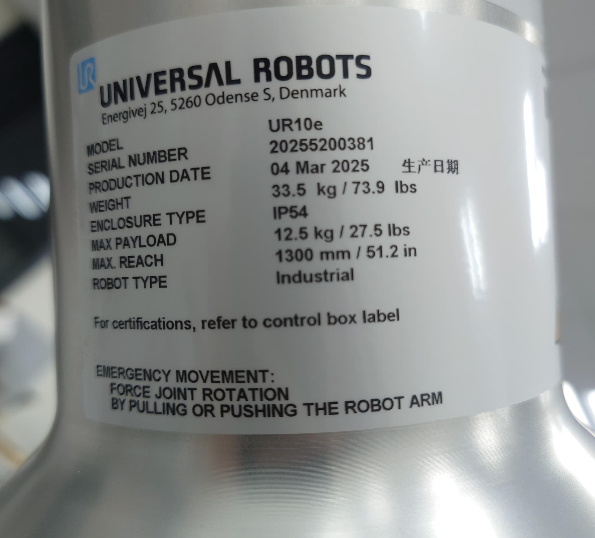

UR10e start shaking when moving shoulder pan joint
We just unboxed UR10e and tried to move each joint of the robot using the Move tab. All the joints are ok except for the Shoulder Pan Joint. It keeps shaking even after we release the touch screen.
Could you please help us to debug and suggest on how to resolve the issue?
Thanks.
If it’s a new robot, I would immediately start a case with myUR. You as the customer should not be responsible for troubleshooting/fixing a brand new robot. UR will likely ask for the log file, and attaching a video to your case would help. Then they will likely send a tech out to replace a bad joint would be my guess. Even though its new, make sure to update Polyscope if applicable, as that will be their first suggestion anyway. Good luck!
thanks for your motivation:
Here are the log we colleted:
  • Video:
ur10e_jointstates_plot_.zip (6.1 MB)
ROS2 bag file:
ur10e_jointstates_0.zip (2.8 MB)
Our UR10e SN:
Hope UR staff could help!
Thanks.
