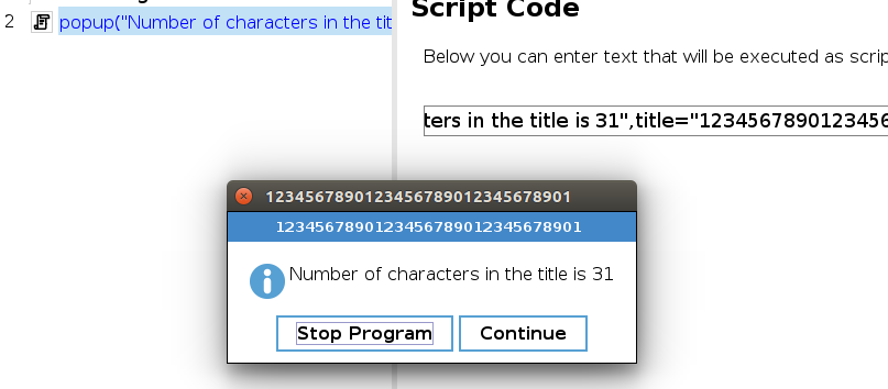

Doesn’t change OP’s request, but you can already do 31 character titles using the popup() via script. You can also do HTML formatting within any of the strings, if that is of any interest.
