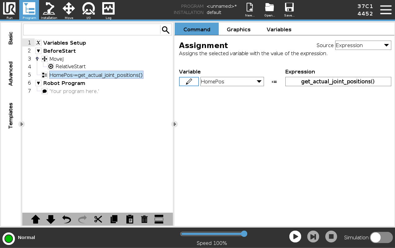

I think this is exactly what I am looking for. Thank you!
Would this be carried out via a script or am I missing something? Thanks!

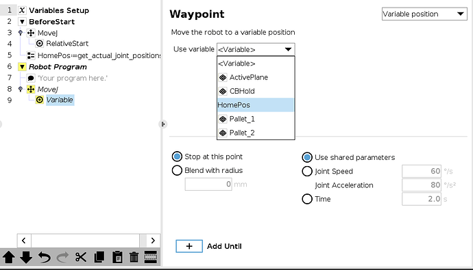

Here’s what it looks like in PolyScope. :slight_smile: Make an Assignment and write the script function as shown.
Later, when you want to move to the position, you make a Waypoint and change its type to Variable (upper right corner) and then pick the variable HomePos.
The RelativeStart waypoint I added allows the robot to start its program without moving to a waypoint first. It’s just a relative waypoint with zero movement.
