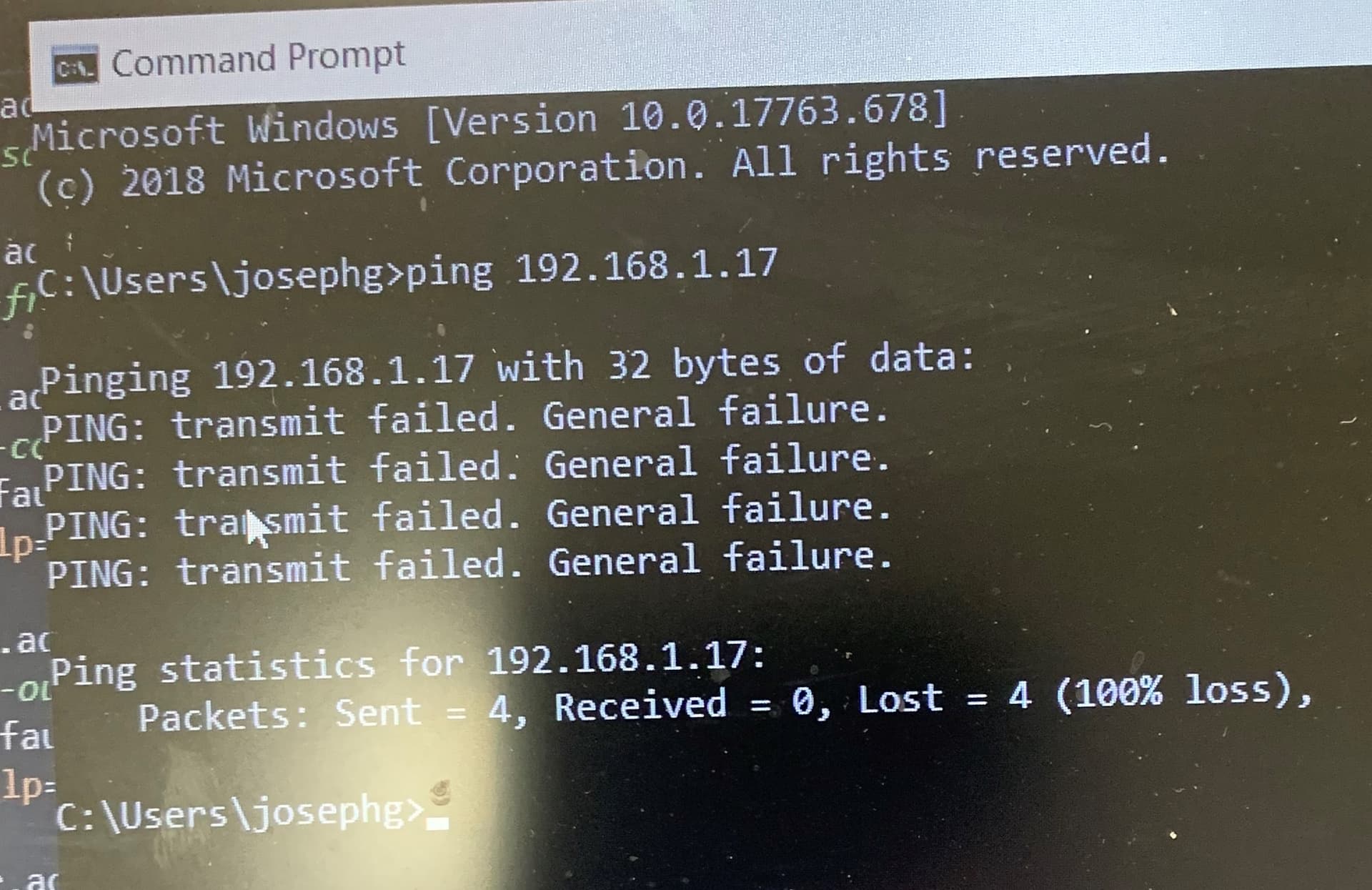

I am having troubles with the RTDE record.py program. I am getting a timeout message as seen below:
Does anyone have a solution to this problem?

Check IP address. Are you specifying the robot host with --host in your launch command? Can you ping the robot from the system running record.py?
@roguebuck thanks for the help!
I checked the IP address as seen in the image below:
I also pinged the robot with the command prompt and got the image below:
The robot’s IP address is set to a static address.
I tried filling the hostname variable with both the IP address 192.168.1.17 and the hostname which is ur-20173355688.
Again thanks for the help.
looks like you have a network problem. Your screenshot of the robot says “Not Connected to Network”
Ping results imply the same.
I know this sounds rudimentary but most root causes are very silly in hindsight … Is the robot physically plugged into the network?
Try a ping with the computer plugged directly into the robot to eliminate potential sources of error.
@roguebuck good eye.
Just to let you know the top screenshot was only for an IP address reference. The, “Not connected to network” message goes away when I plug an Ethernet cable from the robot to a laptop.
The set up menu where I checked the IP address, mask and gateway also say it’s connected when I plug in the Ethernet cable.
Do you know if I need to enable the Installation EtherNet/IP Adapter helps?
ok, great. but you still cant ping. so there is still a network misconfiguration.
what is the IP of the laptop?
No, “Ethernet/IP” is a particular fieldbus protocol. You do not need it enabled, but I dont think its relevant here and I dont think it matters in this case.
@roguebuck I got my laptop connected to the robot and ran the record.py file. In a few seconds it generated a csv file with over 19,000 linens of data. The problem was my laptop had firewalls the IT department had to remove.
Thanks for the help.
Yup…its usually the silliest things.
FYI - “PING: general failure” is telling us its failing harder than just not getting a ping response. general failure implies the ping never even left the computer.
