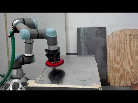

I tried as you said, just moving only the first joint and I get the same result.
Once the first moveJ movement sets the robot in the
first pose, there are just 2 lines: the increase of the joint value, and the servoj command.
I recorded the test, you can see it here.

This program works fine on a UR5e robot here. If I uncomment the sync however then I get a similar issue to you… you don’t have anything else in there that could be adding a delay to the loop?
You nailed it!
I had a sync call related to the test I did before with the moveJ command.
However, to be honest, even if I was aware of it I’d have told you I had only " the increase of the joint value, and the servoj command", because I though the sync call was not harmful. So my bad.
Lesson learned.
Thanks a lot for the help.
Yeah it’s a bit counter-intuitive that your sync command is getting your movement out of sync here :slight_smile: Glad you found the issue!
