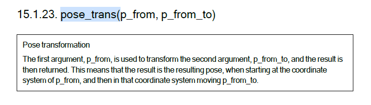

HI,
UR will move to waypoints in base feature. Using function pose_trans() and pose_inv() together can move to points in specific feature.
