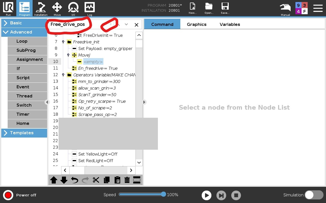

I have lost all my installation variables, and therefore I cannot run my program due to an “unfinished program”. I have only lost my variables. The rest of my installation file is as I left it the last Thursday.
Being optimistic, I decided to just reassign all of them with the exact name(I only have about 30). But it seems like somewhere the controller still has access to these variables a
nd will not let me reassign the same name. I have attached pictures from installation variables, the searching for the variable and features.
The specific one I am looking for here is “Free_drive_pos”, which is a pose I assign as “get_actual_tcp_pose()” and then go to the position during initialization. So, I know for sure that I am not using it in a subprogram or script.
I am having this issue with 9/30 of the variables I used to have in my variables file.
To get back up and running, could some of you suggest where I might find these variables or something? Or tell me how to find/delete old dependencies?

The filename.variables file does not contain the declaration or instantiation of the variables. It only contains the values those variables held when the program was stopped or robot shut down. The declaration of the variables is within the INSTALLATION file itself (e.g. default.installation). This you can see under Installation->General->Variables… this is where they get declared.
That being said, I don’t have a clear explanation for why polyscope thinks these variables are undeclared (why they are yellow in the program tree). Usually restarting polyscope solves this problem. Sometimes you have to suppress the variable in the program tree and then go back to the installation tab and recreate them.

I tried to suppress the variables in the program(what I tried showing with the picture of the program, as you can see the position is not used in the program any more), it is not declared within installation nor as a feature. The variable do not exist in the installation file nor the program, or at least the part of polyscope that I can acces.
My actual problem is that somehow, even though, the variable is not declared, I can not declare it once again as it is still referenced somewhere.

I did some digging around in our internal bug database and found what I believe is a similar problem. So this is a known bug and it is being worked on. For reference the bug is listed as TEC-693. I was able to fix the problem by editing your installation variables file (20801.variables) and adding a value for the missing variable. As an example : En_freedrive=False So if you wanted to fix this you would have to do this for each variable that was in a yellow state in the tree.
My understanding of the bug is that this seems to happen when you are copying files back and forth from an external computer via ftp or something like that. I think the issue is that Polyscope still has a pointer to the original installation file in it’s memory and when you copy a new file over and attempt to use it somehow (editing something in the program tree perhaps) polyscope will get confused and somehow delete the values for all the installation variables from the 20801.variables file which results in all the installation variables being invalid.
The key to fixing this is to NOT have your installation or program opened while editing the file (20801.variables). SO what I did was I created a new program (blank) within polyscope, THEN opened a different installation file (default), THEN I edited 20801.variables. Once the editing/copying is done then it is ok to open 20801.installation as well as the working program. This would be the technique for copying files back and forth from a development system too.
I think the best advice for you to move forward is to fix the file, establish working values for all the installation variables and then save a backup of the installation variables file (20801.variables.bak) in case this happens again in the future.
Below is a screenshot and example of how I initialized some of the installation variables that were previously not initialized.
Just a bit more clarity on how to avoid this problem. The issue is that you should not have your installation file or program open within Polyscope while you copy a modified installation and/or program to the robot from some external USB drive or via ftp. As an example, if your installation file is called my_installation.installation then open something like default.installation within Polyscope before you copy my_installation.installation on to the robots SD card.
