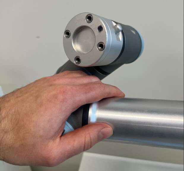

Wrist clamping
The safety system of the also prevents hand clamping between the lower arm and the tool flange. This is prevented by ensuring a safe distance of 2.8cm between these parts so fingers cannot get clamped.
If the robot moves too close to the wrist clamping position limit, the robot issues a C403 protective stop
You can prevent that by increasing the collision geometry for the lower arm in the collision model of the robot.
