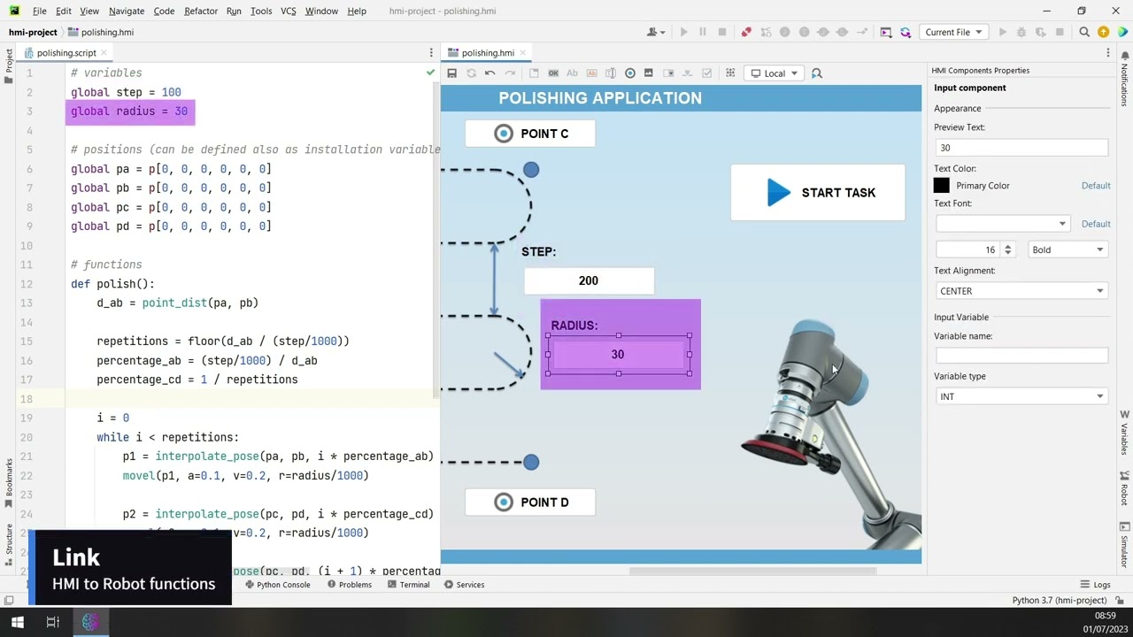

Hi @xu.s.2,
I have an example of the trajectory you want to accomplish:
You can find the code here:
You can change movel with movep if you want a constant velocity profile.
