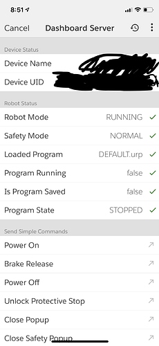

By faulted do you mean protective stopped or a hard fault that stops the controller to where you had to restart the controller at the initialization screen? We use the dashboard server to get safety status, I believe it also shows faults when we have them but can’t recall. Here is a screenshot from our app showing the core data we get back from the dashboard server
Hey Matt, I’ve written something similar to the interface you’ve shown I’m a VB.net forms app, but yes I mean a hard fault like this
Dashboard server closes connection when this happens and cannot be reconnected unless this is cleared on the teach pendent. Now in talking about modbus, the Excel sheet provided on the ur website States that register 258 is the robot status, but I have a 10e,

I think it will just show powered off, that’s what we see in RTDE, not faulted. You won’t know why it’s powered off. The reason Dashboard shuts off is the controller has stopped running and the server is on the controller.
