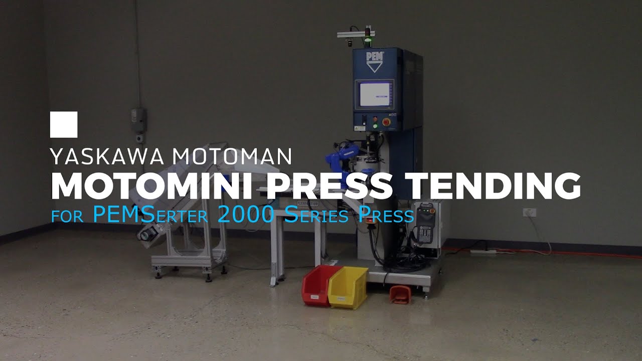

The next application our company is trying to set up is sheet metal clinching using the machine attached
https://www.auto-sert.com/presses/#start
There are examples of this application setup in these links below that are very similar to how we want to set it up
I think that we will be able to set this up with the knowledge we have gained from other applications. The only thing I’m worried about and the main point of this question is the communication between the clinching machine and the universal robot.
Looking through the technical documents and the machine itself i know there isn’t any Digital I/O i can configure with. I don’t have experience using any other communication methods, hence why i have come to this forum to see if the UR community can help.
If anyone can help me find out what the best method to use is, i would be very appreciative. Also any links, videos, information etc, that can be provided would be extremely helpful.

Hm I’m sure someone in the URcommunity has done a similar application and may have some better advice, but here’s what I got:
  1. if the pedal is just a digital input then you could use a 24v mechanical relay the robot could trigger when in position and release when operation is complete, this however doesn’t account for settings changes for the PRESS (settings on press would still have to be manually changed) and/or when the clinching operation is completed by the press (I’m sure there’s an output somewhere you could find). See next points
  2. you need to know the OEM’s input/output specification and/or if the machine can be integrated with other equipment via a PLC or controller (might require a phone call or email with a rep, as I checked your link and even the PDFs don’t give much useful information on this) however if you have the press and are curious you could look under the hood and see what you’re working with. Warning: this might void your warranty if you damage something, I just can’t help myself sometimes so do this at your own discretion. Probably best to just ask the OEM
  3. there are several ways to communicate with the UR, check this link Overview of Client Interfaces if you figure out the communication protocol with the press (MODBUS, Ethernet/IP, Profinet, etc…) then you might be able to narrow your search in the forum for additional help relative to each of these topics. If it requires a PLC I believe UR has a few links to specific PLCs integrated with the UR robots for reference.
