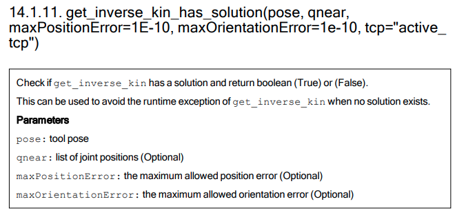

Check if inverse_kin is possible
Is there a possibility to check whether the inverse_kin of a given pose is possible in URScript.
Something like:
if inverse_kin(pose):
Do sth.
end
Cheers
Friedrich
Well I just solved it myself. You can simply use the is_within_safety_limits() function.
Yep! Use this function.
