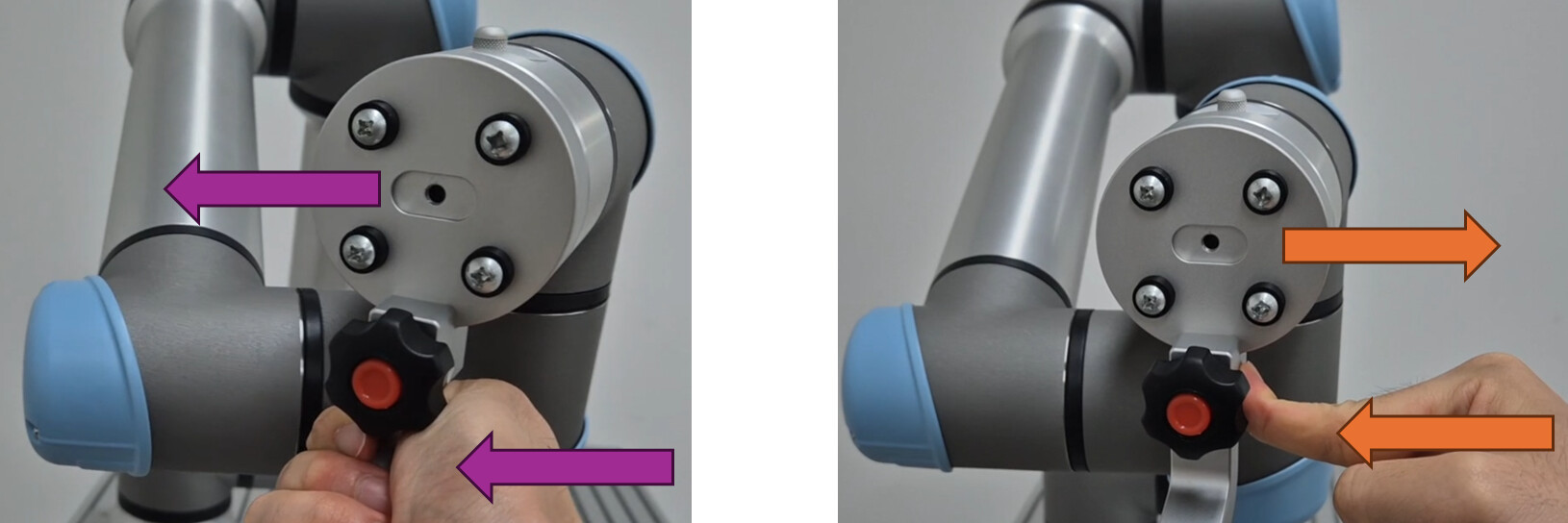

Hello everyone,
I’m working with a UR5e robot and encountered some confusing behavior while using Force Mode. I’d really appreciate your advice or insights.
Here’s my setup:
  • The robot is equipped with an end-effector, and I enabled Force Mode.
  • Force Mode is configured to only allow movement in the ry direction of the tool frame.
  • I tested the setup by moving the end-effector with my hand and also by pressing it with my finger.
The issue I observed is the following:
  • When I firmly grabbed the end-effector and moved it, it responded correctly in the intended force direction.
  • However, when I pressed the end-effector with my finger, it moved in the opposite direction of what I expected.
This was quite surprising, and I’m not sure why this happens.
I’d like to address this problem through software using URScript and Python, but I’m struggling to determine the best approach.
Has anyone experienced a similar situation? What would be the recommended way to handle or fix this issue in software?

Hello EV1,
Thank you so much for taking the time to think deeply about my issue, and please forgive me for not responding right away.
I agree with your point that the UR5e’s Force Mode can behave unexpectedly on rotational axes, especially since the robot estimates the forces based on torque readings from the last joint. I understand that this estimation can introduce some uncertainty, particularly when small rotational inputs are applied (like around the ry axis).
Currently, I’m calling the force_mode() function directly in URScript for testing, with the following parameters:
selection_vector = [0, 0, 0, 0, 1, 0] # only ry allowed
wrench = [0.0, 0.0, 0.0, 0.0, 0.0, 0.0]
limits = [0.001, 0.001, 0.001, 0.02, 1.0, 0.02]
f_type = 2
task_frame = get_actual_tcp_pose()
force_mode(task_frame, selection_vector, wrench, f_type, limits)
At this stage, I’m only testing the basic behavior of Force Mode and haven’t implemented any higher-level control logic yet.
My goal is to first explore software-based solutions, and if those turn out to be insufficient, I’ll then consider hardware alternatives, such as adjusting the degrees of freedom.
Do you know if there’s any general software-based approach that could help compensate or stabilize the internal estimation of force and torque values to address this issue?
I’d like to understand if there’s a known or recommended method to correct this kind of response at the software level before moving toward hardware changes.
Also, one more thought — my end-effector is mounted with four bolts (as shown in the attached setup image), and I wonder if this could somehow influence the internal force estimation or sensor response.
It’s just a hypothesis, but if I were to modify it, would a bolt-free, cap-like mounting structure make a difference?
I plan to experiment with this myself, but I’d really appreciate your opinion if you have any related experience.
Thank you again for your helpful insights and for sharing your knowledge.
