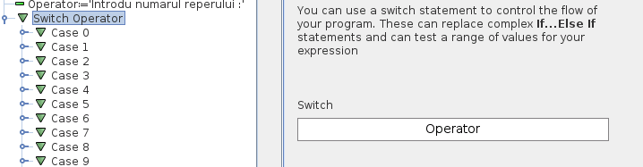

It works, use a variable where you store the value and create a switch case and then put it in to a sequence:
if value = 90 let’s say do something … etc.
You can also link that variable to a physical button input …

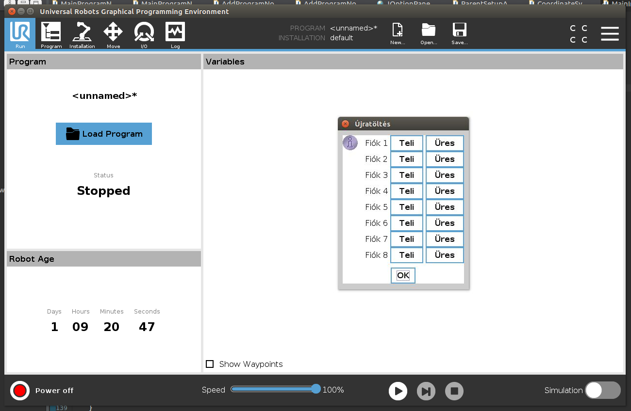

The program is already running on an If structure using internal flags (until I cook up how to change predefined variables). I don’t want to use physical buttons if I don’t have to, I’d rather have buttons on the GUI, but I don’t know how to create a custom popup, that starts only when the program starts and stops with the program. Were I able to do that, there would really be no problem, from there I could program the button however I like, but opening a custom popup with textfields and several buttons is where I’m stuck.
Preferably, I would have something like this:
