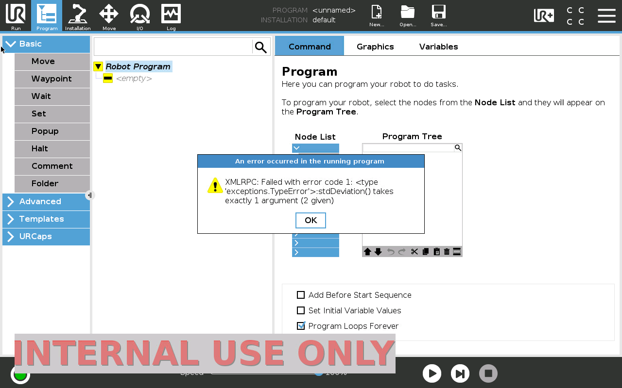

I have a problem with xmlrpc request inside a thread.
The thread containing the xmlrpc request can be killed at any moment then restart.
What happen is that last xmlrpc request was not completed when thread was killed and restarted, then a new xmlrpc request occured. It seems that the new request parameter is append to the uncompleted request and the server receive a request with 2 parameters and an error occure.
It occure with our C++ xmlrpc server and I reproduce that with a simple python server.
Here the code to reproduce easily the error:

Thank you for providing a great minimal example!
Where does the error occur?
As an error message in PolyScope? In the daemon?
What software version is used?
**Author:** ![malacasse](https://sea2.discourse-cdn.com/flex020/user_avatar/forum.universal-robots.com/malacasse/32/56_2.png) [@malacasse](https://forum.universal-robots.com/u/malacasse)\
**Post date:** [February 11, 2019, 2:13pm UTC](https://forum.universal-robots.com/t/xmlrpc-request-in-thread/3610/3 "2019-02-11T14:13:15Z")
I obtain same result on these Polyscope versions:
URSoftware 3.8.0.61336
URSoftware 3.9.0.6470
URSoftware 5.2.0.61336
URSoftware 5.3.0.6450
Here is the error
 ![image](https://us1.discourse-cdn.com/flex020/uploads/universal_robots/original/2X/c/cca911c05b2c2ae7c26b0c7ccfb9c6b5e0a96b36.png)

This bug has been reported, and moved to Bugs category.

In the release note of polyscope 5.5.1 it is written :
- Fixed issue where killed XML-RPC calls with arguments in thread caused wrong arguments
I tested with URsim 5.5.1 and the problem seems solved.
Can you validate that this issue is solve ?
