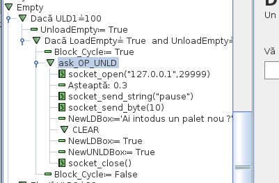

**Author:** ![anon63938643](https://avatars.discourse-cdn.com/v4/letter/a/da6949/32.png) [@anon63938643](https://forum.universal-robots.com/u/anon63938643)\
**Post date:** [September 3, 2021, 5:57am UTC](https://forum.universal-robots.com/t/using-di-do-asigned-special-functions-in-program/16136/6 "2021-09-03T05:57:00Z")
If you are creating a local dashboard TCP server on your robot then you can use also variables to start, pause and stop the program using socket.
![image](https://us1.discourse-cdn.com/flex020/uploads/universal_robots/original/2X/3/338d1a91b9a11e79c3ebcfc4e1c4bd8f2afd075a.png)
**Author:** ![matteo.stagi](https://avatars.discourse-cdn.com/v4/letter/m/dbc845/32.png) [@matteo.stagi](https://forum.universal-robots.com/u/matteo.stagi)\
**Post date:** [May 6, 2022, 10:08am UTC](https://forum.universal-robots.com/t/using-di-do-asigned-special-functions-in-program/16136/7 "2022-05-06T10:08:03Z")
How is the script command ‘pause’ exactly ?
**Author:** ![MikeM](https://sea2.discourse-cdn.com/flex020/user_avatar/forum.universal-robots.com/mikem/32/3114_2.png) [@MikeM](https://forum.universal-robots.com/u/MikeM)\
**Post date:** [May 6, 2022, 12:40pm UTC](https://forum.universal-robots.com/t/using-di-do-asigned-special-functions-in-program/16136/8 "2022-05-06T12:40:49Z")
Basically you are opening up the Dashboard Server within the robot program using the socket\_open() command and the IP 127.0.0.1 and port 29999. Some people use a true/false loop here to loop that command until the connection is made, however waiting 0.3secs is fine then they use socket\_send\_string() to send **pause** to the dashboard server which is basically like pressing the pause button on the teach pendant, this is followed by send byte “10” which is just the newline character “\n”. This command has been depreciated (depending on version of Polyscope you are running on robot) you can use _socket\_send\_line(“pause”)_ which will save you from writing an extra line of code.
Hope that helps or answered your question, and best of luck!
