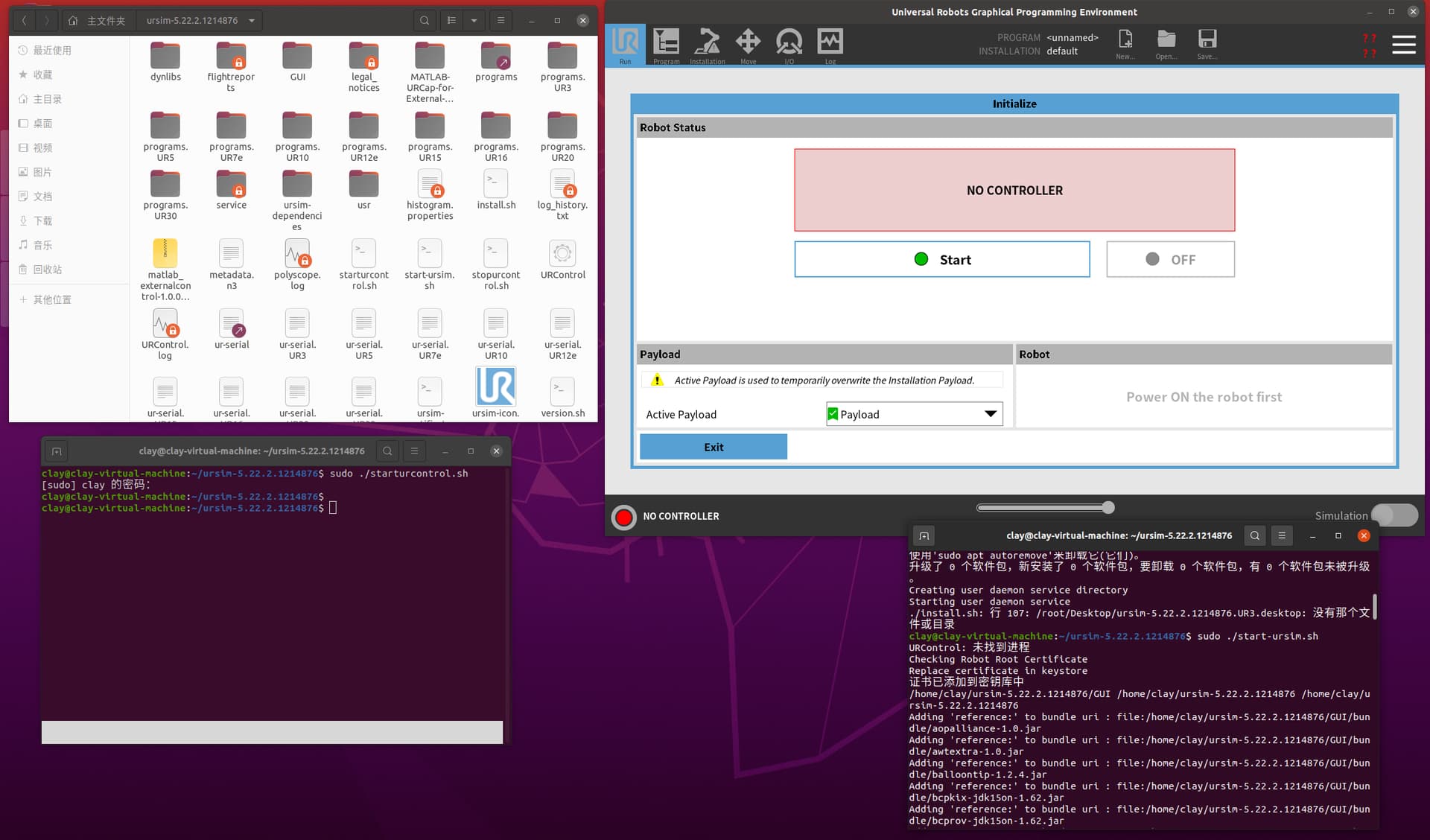

![ef26bfc4-52dd-4839-9c8b-352dafa86f15](https://us1.discourse-cdn.com/flex020/uploads/universal_robots/original/2X/5/5eb962fbd8d1d7f28147d91594ab56e310f07c8d.jpeg) I am using Ubuntu 20.04 and following the solution provided on the official website. I am not sure if it is due to the command ‘sudo apt install libxml rpc-c++8v5: i386-y’, as when I enter this command in the terminal, it displays’ E ‘indicating that the package cannot be located. Therefore, I installed’ sudo apt install libxml rpc-c++8v5-y '.

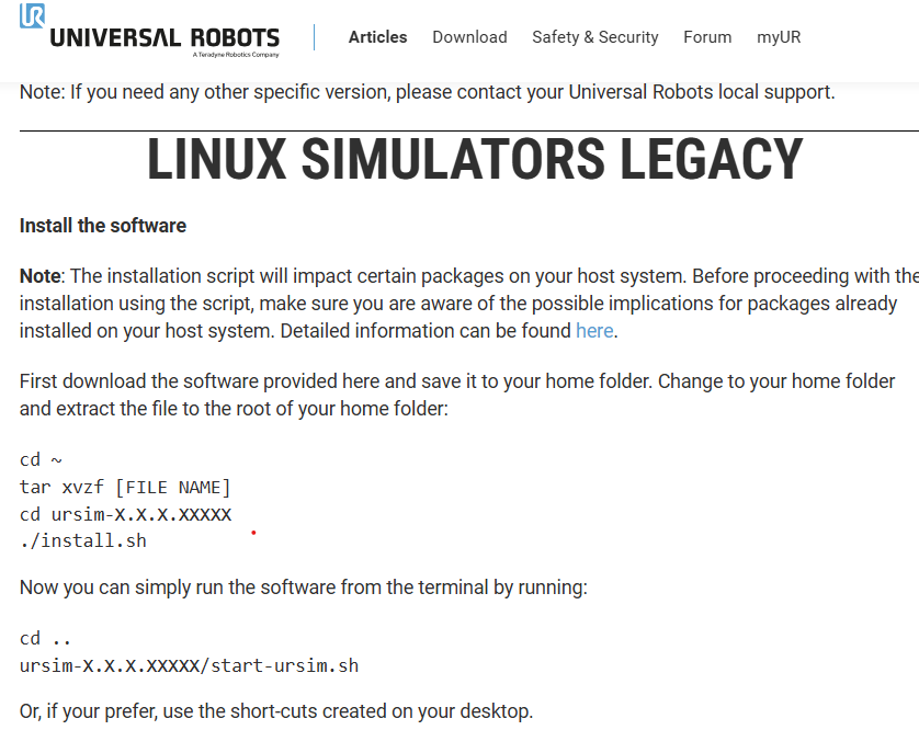

This problem has happened to me before!
What you need to do is:
1- Open the folder containing the URSim\_Linux-X.X.XX.tar.gz file via the terminal: cd FolderName
2- Extract the URSim\_Linux-X.X.XX.tar.gz file via the terminal: tar xvzf URSim\_Linux-X.X.XX.tar.gz
3- Open the extracted folder via the terminal: cd ursim-X.X.XX
4- Run the install.sh file via the terminal: ./install.sh
This will create shortcuts on your desktop; you can delete them.
5- You can now launch Ursim via: ./start-ursim.sh

Thank you, but it still cannot be resolved
