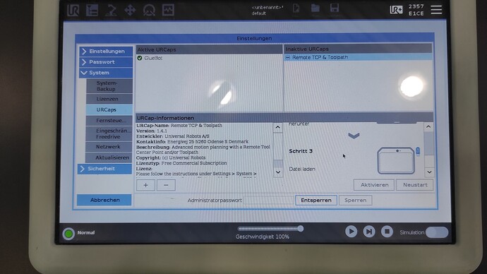

Hello everyone
I’m not so experianced with the Ur, so maybe my question is a little bit a beginner question…
I want to activate the URCap Remote TCP & Toolpath. Therefore I have registred the robot and have downloaded the licence-file. In the settings the activate button is grey. so my question is: Is it necessary to be logged in as administrator to activate?
Thank you in advance

**Post date:** [October 7, 2024, 7:10am UTC](https://forum.universal-robots.com/t/urcap-activate-administrator-necessary/36376/2 "2024-10-07T07:10:29Z")
If URCaps are set to be protected by the Admin password, then yes. You will need to unlock it with the Admin password, before you can do anything. 🙂
