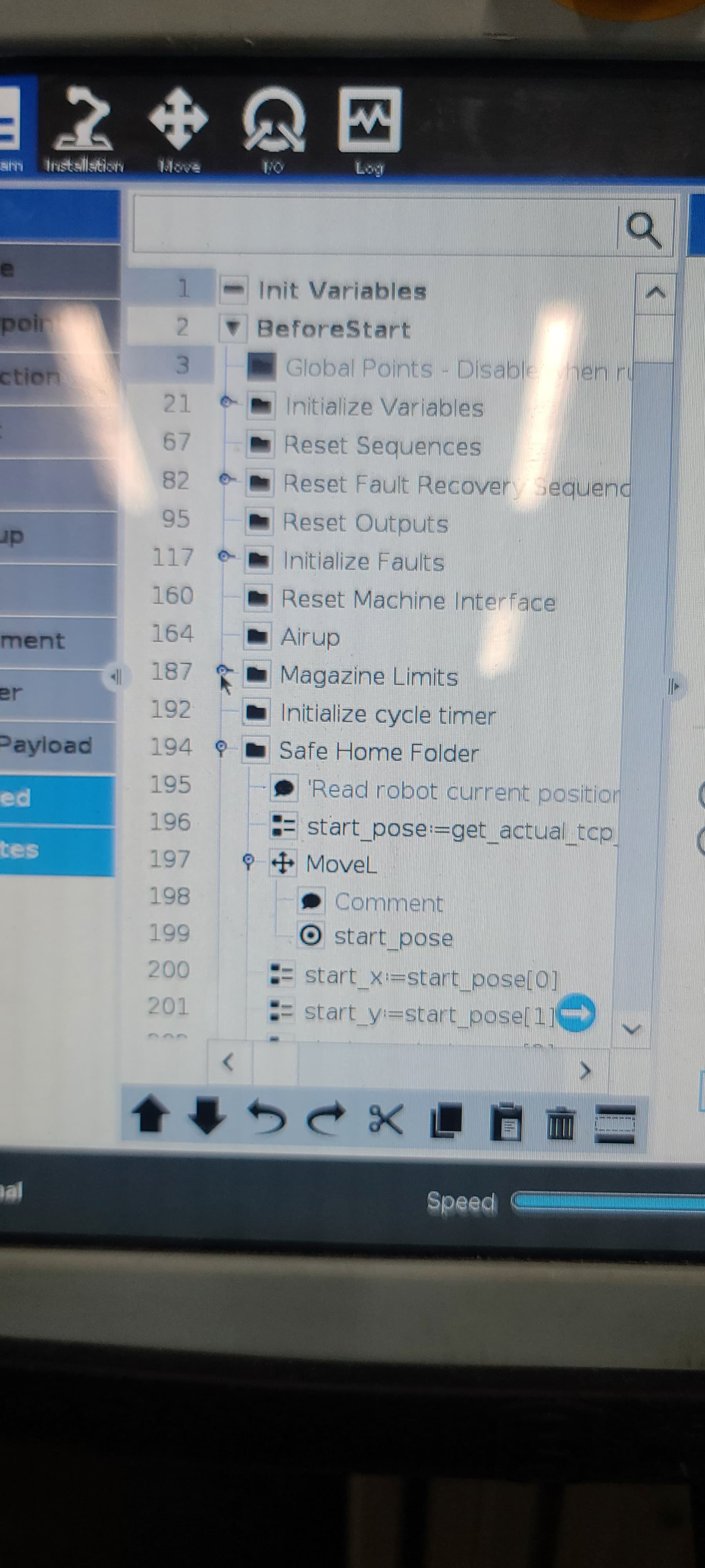

After updating to the new polyscope, When I try to start from the beginning of my program, the Waypoint the robot wants to move to is no longer my home position. It is a way point way down in my safe home folder. This is before the program even start to run…
Has anyone ever seen this?
I have checked my home position, it’s correct. I loaded from a backup, both the program and the installation files, still the same issue.
any help greatly appreciated.

I went from 5.9.1 to 5.11.4
the safe home is based on the TCP location X,Y and Z… so i get the actual TCP then using ifs and elseif to determine what set of moves to safely get home.
but that is after the program start, the issue I am having is before all of that
 ![20210929_1214431](https://us1.discourse-cdn.com/flex020/uploads/universal_robots/original/2X/f/f37ee0cb9b0780bbfc467a54c8bdce2b3485bc49.jpeg)
the move to is a way point from line 243 in my program
 ![20210930_0729551](https://us1.discourse-cdn.com/flex020/uploads/universal_robots/original/2X/0/04e01ce411346468975f9af57dddbe6da1b55e72.jpeg)
that waypoint is in my safe home
why is the program starting from 243?

Can you share a photo that shows the Safe Home Folder from line 194-243? I see you’re gathering info about the current robot position at the beginning of the Safe Home Folder, so at the moment, I would guess an if statement condition is being met to get the robot moving at line 243. Have you made any changes to your tcp that would result in start\_pose generating some different values?
You can also PM me your program, installation, variables file, and your robot model if you’d like, and I can take a look at the program in the simulator.

I think your on to something here. I am going to try a few things here, and i will get back to you in a little bit.
I have installation variables for start\_z, start\_y and start\_x and same for rx, ry, rz… these variables seem to be reverting to meet a condition. Like you said…
We might be on the right path here

When you start the program, is the robot automatically trying to go to TopDevAppr\_1, or are you getting the move into position prompt, and you need to use the “move here” button to get the program running?
Where is the “If ST60\_RIGHTRET and St60\_LeftRet” statement written? Is it nested inside the ElseIf above, or is it at the same level?
Also, do you happen to use more than one TCP in your program, or have more than one TCP saved in your installation? When you call the get\_actual\_tcp\_pose() function, it will return the pose of the **active** TCP. Maybe the software update reset the active TCP, so you’re starting your program and it’s returning values that meet the ElseIf requirements, because those values are based on a different TCP in the installation file.

-It is a move into position prompt. so it wants to use the “move here” before even starting the program.
-that if is nested under the else if, so it is only seen if conditions are met
-only one TCP saved in the installation.
I do not understand why the move to position, before the program starts is that waypoint. The move to position should be the saved home position, correct?

The “move into position” will be determined by the first fixed waypoint in the program. It would only be the Home position in your installation if you use the Home program node as the first fixed waypoint.
However, if the first waypoint in a program is a variable or relative waypoint, there should never be a “move into position” prompt. From what I can tell, you define start\_pose at line 196, and move to it at line 199, so your program should be automatically starting without prompting you to move to TopDevAppr\_1.
It seems like for some reason, this variable waypoint is not being properly recognized. Can you delete the MoveL at line 197, then add it back the same way it is set up now?

I have done that, even tried MoveJ. no change. maybe the update doesn’t let you use a variable position as a starting waypoint?
I’m at a loss… before the update it would never prompt to move into position, just would get start from unknown position prompt.
