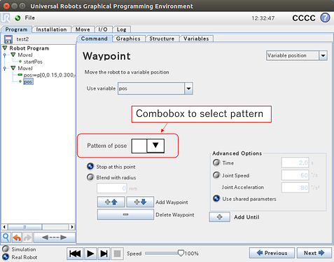

The feature is that the pattern of pose is selected for variable position by “MoveJ”.
# Why is it needed?

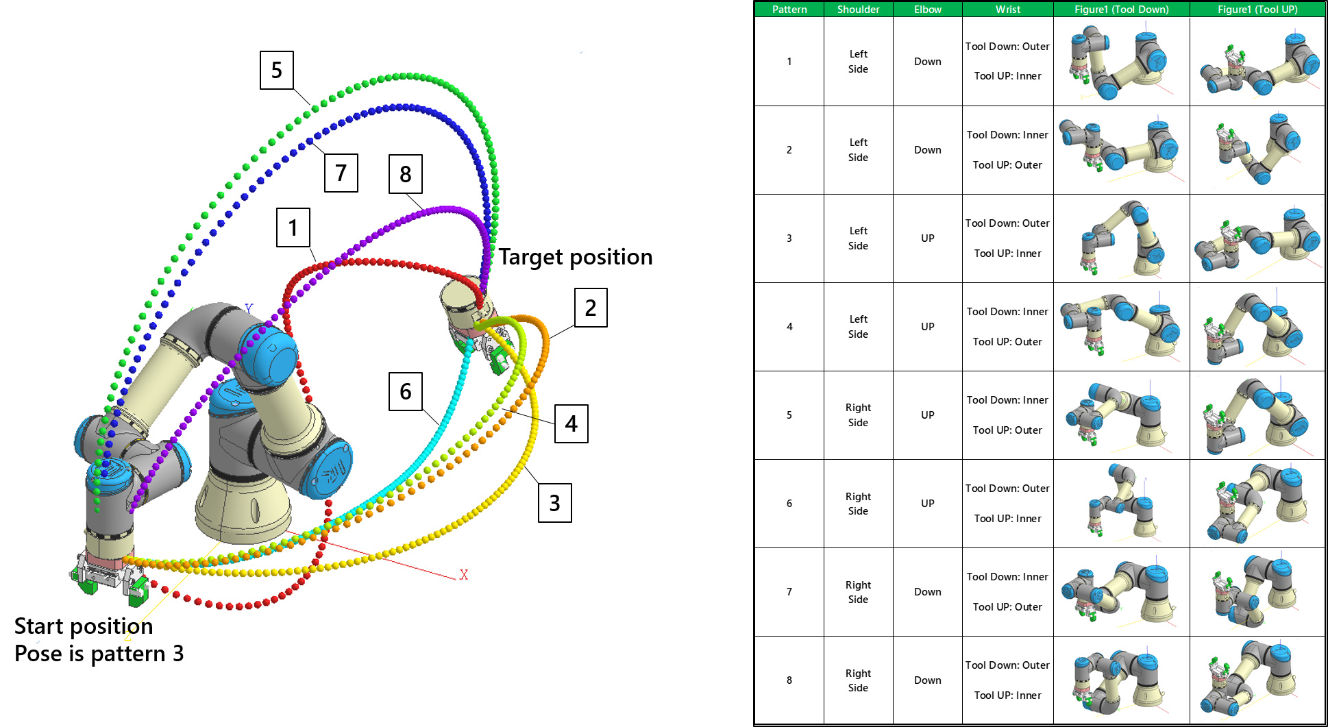

The arms have sometimes crush when target point is variable position and robot moves by “MoveJ”.(ex: using robot vision.)
Inverse kinematics has a muximum of 8 patterns of pose, so trajectories also are existed a maximum of 8 patterns.
For example, In figure below, I want to select 3rd pattern on target position.
But I cannot select pattern and trajecory and arms hit if 6th trajectory is selected by controller.
 ![patterns](https://us1.discourse-cdn.com/flex020/uploads/universal_robots/original/2X/a/ac91e738a55c7ed8f9eb3e74f97f5bd99a263419.jpeg)
 ![_20200730_170428](https://us1.discourse-cdn.com/flex020/uploads/universal_robots/original/2X/f/f5e34aaca6a0b1adc34f73ae6bdd7047307cbf8a.jpeg)
**The arms hit when 6th trajectory is selected.**
 ![feature](https://us1.discourse-cdn.com/flex020/uploads/universal_robots/original/2X/b/b20fba5174d001662d0f1f74d0761476cfb3cd43.jpeg)

i don‘t get the advantage of the patterns. Shouldn‘t waypoints both save Pose and JointPositions and have their unambigious Position with the Pattern as the user has teached it? I think adding the ability to chose the Pattern would add too much complexity and i‘m shure that a lot of our customers would have issues to understand.
If in a case where only the pose is available for a waypoint to be teached, it would be more benefical having the suggestion to move to the pattern that is close to the actual joint pisitions the robot has before going to that waypoint (in that example it would be picture 3)
Avoiding collisions with itself, the plane and the tool should be self evident.

I think you can realize it be making a program three like this:
 ![Screenshot from 2020-08-07 01-34-35](https://us1.discourse-cdn.com/flex020/uploads/universal_robots/original/2X/b/bdb70b6373a9b7acf5149fd71098cd72e5ea81fc.png)
Then you should provide the qnear to select your pattern. @anon77491662 I think you should reconsider the UR robot 😉
I think the discussion as specifying the pattern as an index rather than a specific qnear is interesting. I wounder if everyone have written a script function for that purpose…
