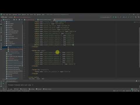

I hope someone will be able to assist you with that question, but in the meantime feel free to check this video which is part 1 of a full example of implementation trajectory following using servoj and RTDE (using python) . I am just a student working with the robot as well and by no means an expert, so maybe the presented way is not the most professional and correct, but it works
[![](https://img.youtube.com/vi/ah9ajIyjzFg/hqdefault.jpg "Universal Robot RTDE tutorial #4 (Full program implementation Part 1/4) Servoj/inv\_kin()") ](https://www.youtube.com/watch?v=ah9ajIyjzFg)
I will make another video showing robotic implementation soon
