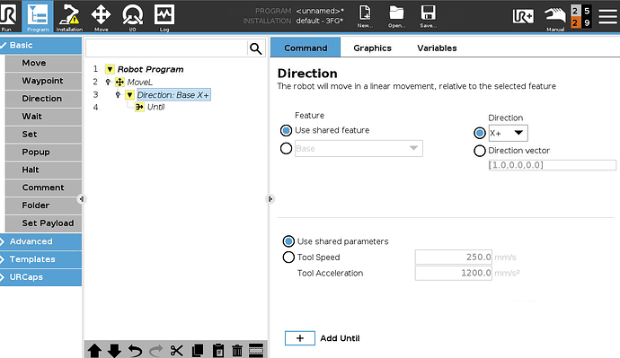

It may be a newer feature. When I select the Direction node, it drops in a MoveL command with the Direction: Base X+ and an Until … sub-node already placed in the program.
Here’s a screenshot showing a Direction node selected within a blank program.
This is from a different machine - as I mentioned, the one using this feature is turned off so I can’t access it from home.
 ![image](https://us1.discourse-cdn.com/flex020/uploads/universal_robots/original/2X/1/17c088c4e23b2794881a7fbf8f44595104d4ea6e.png)
I believe the Direction node is just calculating a waypoint in the right direction, so if you’re already moving towards a waypoint, then using the standard MoveL and selecting Add Until (force \> 20) should give you the same functionality I’m using. (assuming the Add Until feature isn’t new, also).
