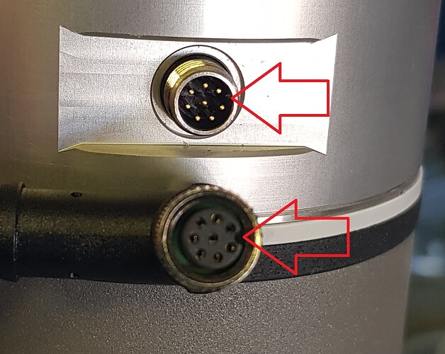

**Overview**
We have improved the M8 connector at the flange to move towards a more robust connector solution.
**When:** The first Cobot with M8 female will not ship before September. Detailed information about the implantation date will be announced during Q3 2024.
**Detailed info:** The current M8 connector will be changed from a male version to a female version. The connector will be inside the tool cap as illustrated in the pictures below.
We will provide an adaptor (15 cm adaptor cable, Male – Male M8) to soften the transition and enable tools with the current connector type.
 ![m8_connector](https://us1.discourse-cdn.com/flex020/uploads/universal_robots/original/2X/0/01ac58767977b182063283db2b0da7c87f8bef9a.jpeg)
**More information:** [Product Change Notification: Change to M8 female connector on the e-Series](https://www.universal-robots.com/articles/ur/documentation/product-change-notification-change-to-m8-female-connector-on-the-e-series/)
