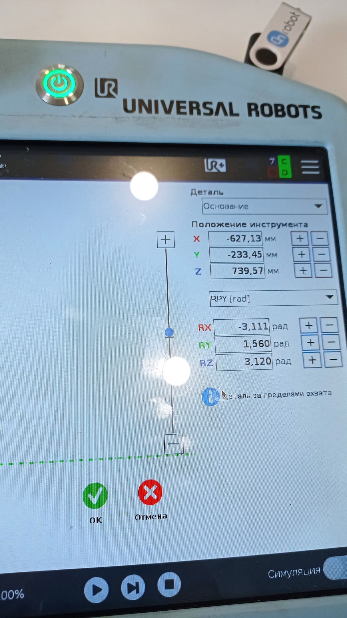

I have created the below plane
 ![image](https://us1.discourse-cdn.com/flex020/uploads/universal_robots/original/2X/c/cffbcbdda3ae19c4e89cb96ed37cbd134acf5c7a.jpeg)
In the script plane is written as p[-0.6271267633975325,-0.2334469065559606,0.7395722520063815, **0.04100748901117013,1.5812879442196548,-0.04108451531028778**]
PRY[rad] **-3.111, 1.56, 3.12** and **0.0410, 1.581, -0.041** the same plane. However, if I write a plane in the script as p[-0.6271267633975325,-0.2334469065559606,0.7395722520063815, **-3.111, 1.56, 3.12**] then the robot reacts incorrectly. Why?
**Author:** ![bba](https://sea2.discourse-cdn.com/flex020/user_avatar/forum.universal-robots.com/bba/32/555_2.png) [@bba](https://forum.universal-robots.com/u/bba)\
**Post date:** [September 1, 2021, 8:14pm UTC](https://forum.universal-robots.com/t/problem-with-plane/16216/2 "2021-09-01T20:14:14Z")
That’s because what you see on that screen is in RPY form (the rotations) and what the URcontrol engine expects when using script is rotation vector form. There is a function in urscript manual called rpy2rotvec() that will do the conversion for you.
