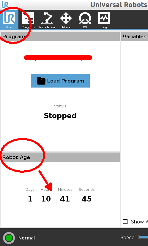

**Post date:** [September 3, 2021, 2:43pm UTC](https://forum.universal-robots.com/t/operating-hours-counter-ur/16286/2 "2021-09-03T14:43:28Z")
You should find it on the Run tab on the teach pendent.
 ![image](https://us1.discourse-cdn.com/flex020/uploads/universal_robots/original/2X/b/b631759c7240d2313156f1b3fda9b5002f687e65.png)
**Author:** ![mvrooij](https://sea2.discourse-cdn.com/flex020/user_avatar/forum.universal-robots.com/mvrooij/32/2151_2.png) [@mvrooij](https://forum.universal-robots.com/u/mvrooij)\
**Post date:** [September 3, 2021, 2:58pm UTC](https://forum.universal-robots.com/t/operating-hours-counter-ur/16286/3 "2021-09-03T14:58:34Z")
that screen isn’t available on a CB3…

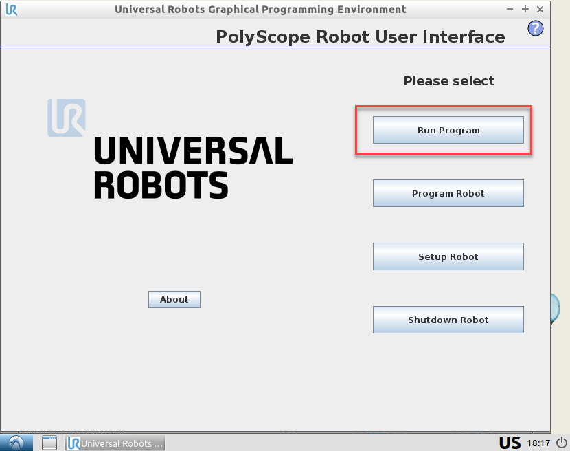

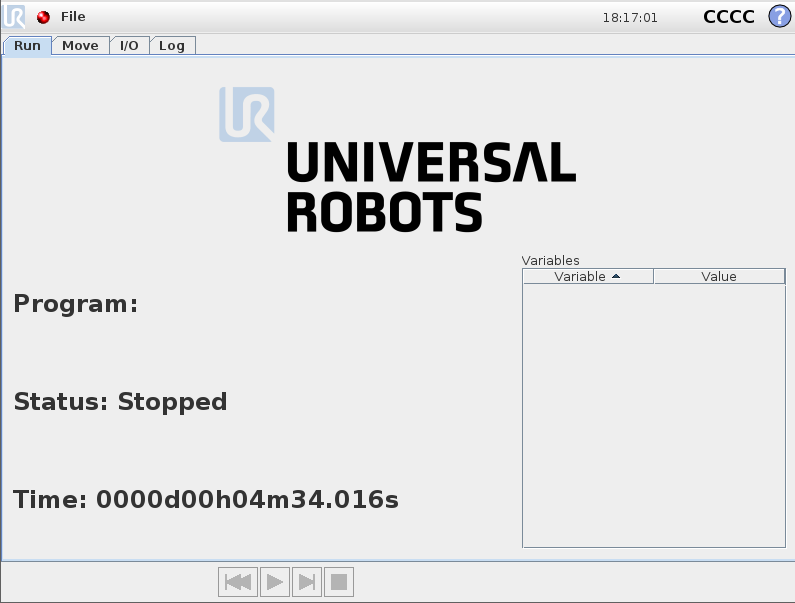

**Author:** ![sya](https://sea2.discourse-cdn.com/flex020/user_avatar/forum.universal-robots.com/sya/32/216_2.png) [@sya](https://forum.universal-robots.com/u/sya)\
**Post date:** [September 3, 2021, 4:17pm UTC](https://forum.universal-robots.com/t/operating-hours-counter-ur/16286/5 "2021-09-03T16:17:59Z")
Hi @mvrooij
 ![image](https://us1.discourse-cdn.com/flex020/uploads/universal_robots/original/2X/b/b7cd9878e6ccf0f970829e391f2e99e13b91ad20.png)
 ![image](https://us1.discourse-cdn.com/flex020/uploads/universal_robots/original/2X/7/7a7a728a57126fbb770070e50bf9bd464fc80caa.png)
