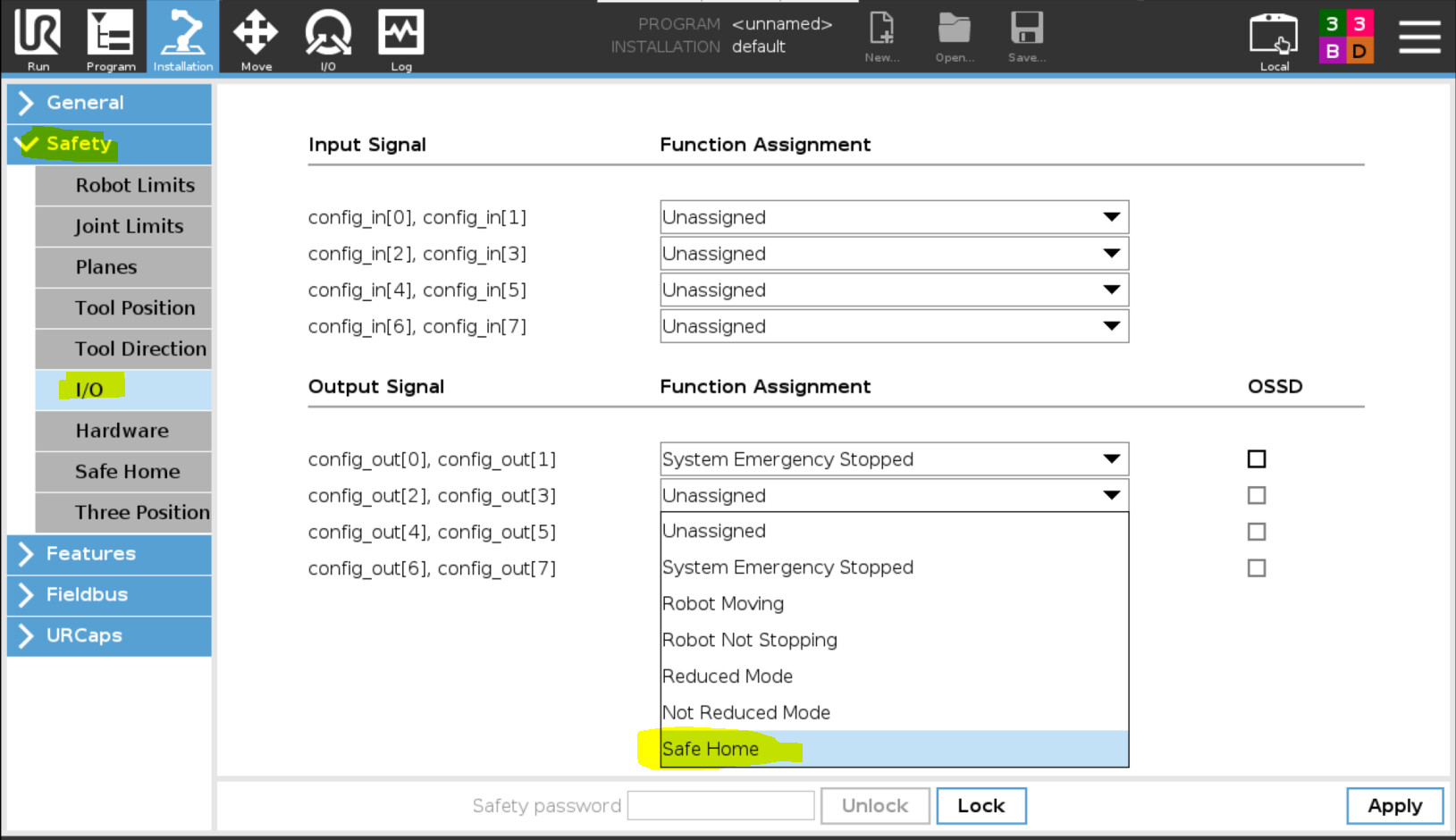

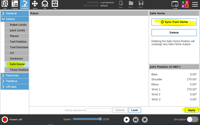

**Author:** ![kadams](https://sea2.discourse-cdn.com/flex020/user_avatar/forum.universal-robots.com/kadams/32/4024_2.png) [@kadams](https://forum.universal-robots.com/u/kadams)\
**Post date:** [April 20, 2022, 7:03am UTC](https://forum.universal-robots.com/t/obtener-en-un-plc-la-posicion-home-por-comunicaciones/20565/5 "2022-04-20T07:03:36Z")
Good morning @anon24758380
Did u configure a “Safe Home” position?
To do this you have to go to “Installation”-\> “Safety” → “Safe Home”:
 ![image](https://us1.discourse-cdn.com/flex020/uploads/universal_robots/original/2X/7/72ed23bd18de7315319606089fbdb22cf824ec82.png)
After that you can select at “Safety” → “I/O” , “Safe Home”:
 ![image](https://us1.discourse-cdn.com/flex020/uploads/universal_robots/original/2X/f/fe49050ec12a755fe44e6614ff255de98416966e.jpeg)
Greetings from Luxembourg!
**Author:** ![anon24758380](https://avatars.discourse-cdn.com/v4/letter/a/e9c0ed/32.png) [@anon24758380](https://forum.universal-robots.com/u/anon24758380)\
**Post date:** [April 20, 2022, 10:24am UTC](https://forum.universal-robots.com/t/obtener-en-un-plc-la-posicion-home-por-comunicaciones/20565/6 "2022-04-20T10:24:04Z")
Muchas Gracias
Así funciona correctamente.
