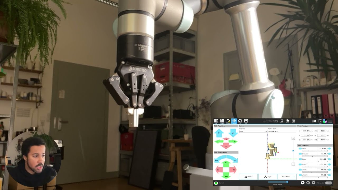

The University where I work acquired a robotiq Vacuum gripper. We are trying to use it with a cobot UR10e and with a plugin fo grasshopper called robots. I am trying to find a way to use the gripper with grasshopper (We already installed the URcap and it is working using the teach pendant)
Can anyone give me a hint on how to do it, please?
Thanks in advance
**Author:** ![robin\_gdwl](https://sea2.discourse-cdn.com/flex020/user_avatar/forum.universal-robots.com/robin_gdwl/32/2676_2.png) [@robin\_gdwl](https://forum.universal-robots.com/u/robin_gdwl)\
**Post date:** [May 29, 2026, 4:38pm UTC](https://forum.universal-robots.com/t/how-to-use-a-robotiq-gripper-with-grasshopper/39520/2 "2026-05-29T16:38:47Z")
I created a tutuorial on this very topic a while ago.
Depending on your version of Polyscope the shown method might not work but its a good starting point.
[![](https://img.youtube.com/vi/9ENygL6V1Ao/maxresdefault.jpg "UR Robot Grippers and URCaps in Grasshopper") ](https://www.youtube.com/watch?v=9ENygL6V1Ao&t=195s)
